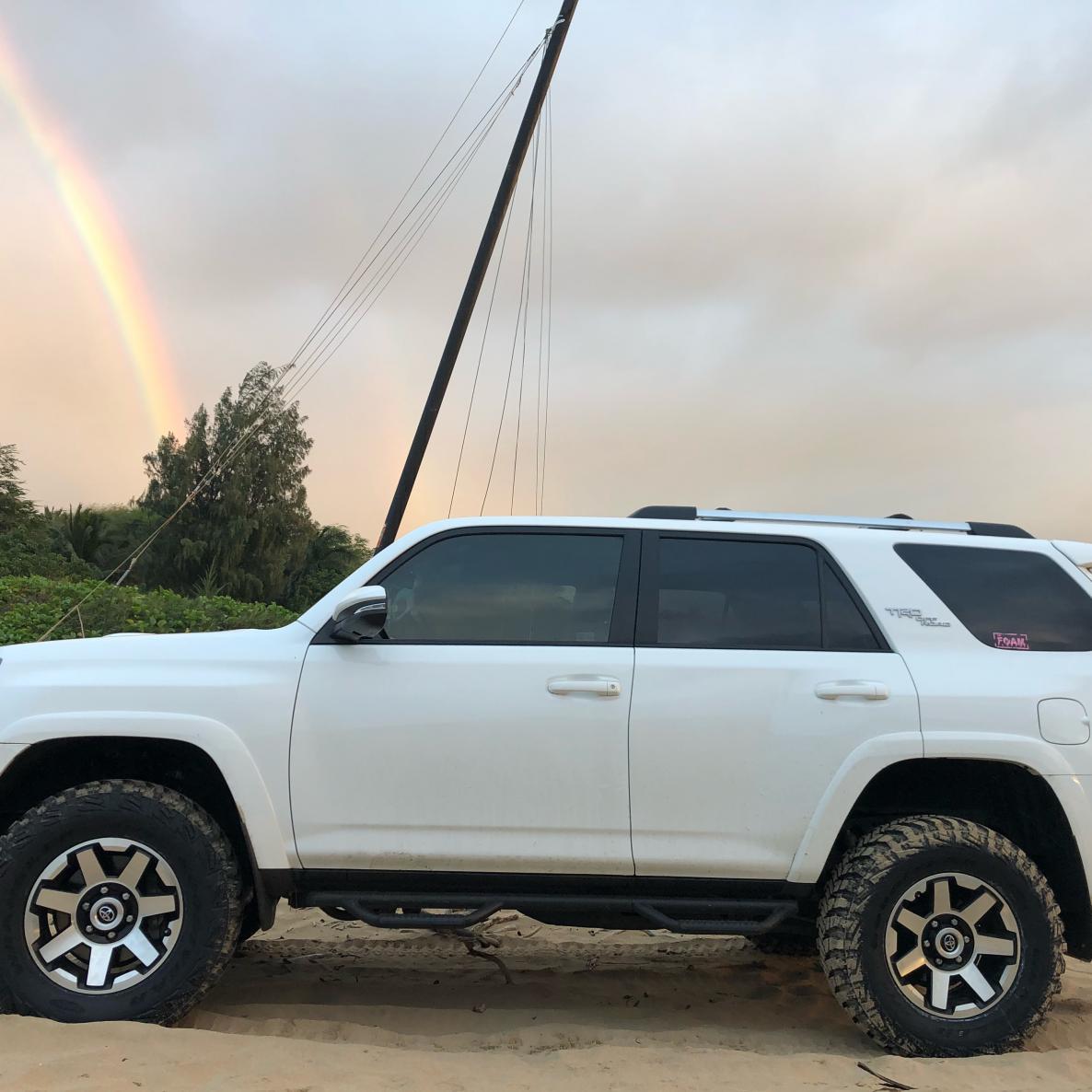

New tires today.
Good year wrangler MTR’s 275/70R17.
Bilstein 5100 2.5”up front. Daystar 1.5” spacers rear.
Fender liners pushed fwd.
ARB twin compressor on Slee off road bracket.
Group 27 batterie.
Bud built hidden winch mount , super winch 9500 synthetic rope.
Factor 55 hook and 1.5” factor 55 hawss.
