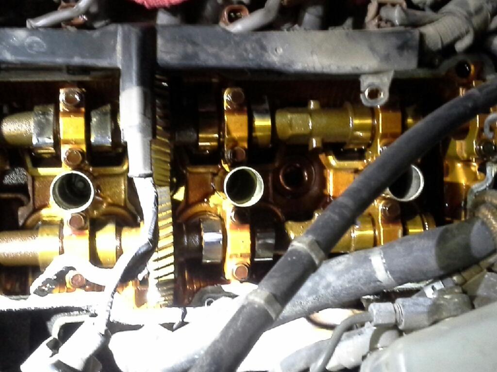

That is NOT sludge. And if you removed the VCs - it should look like this.

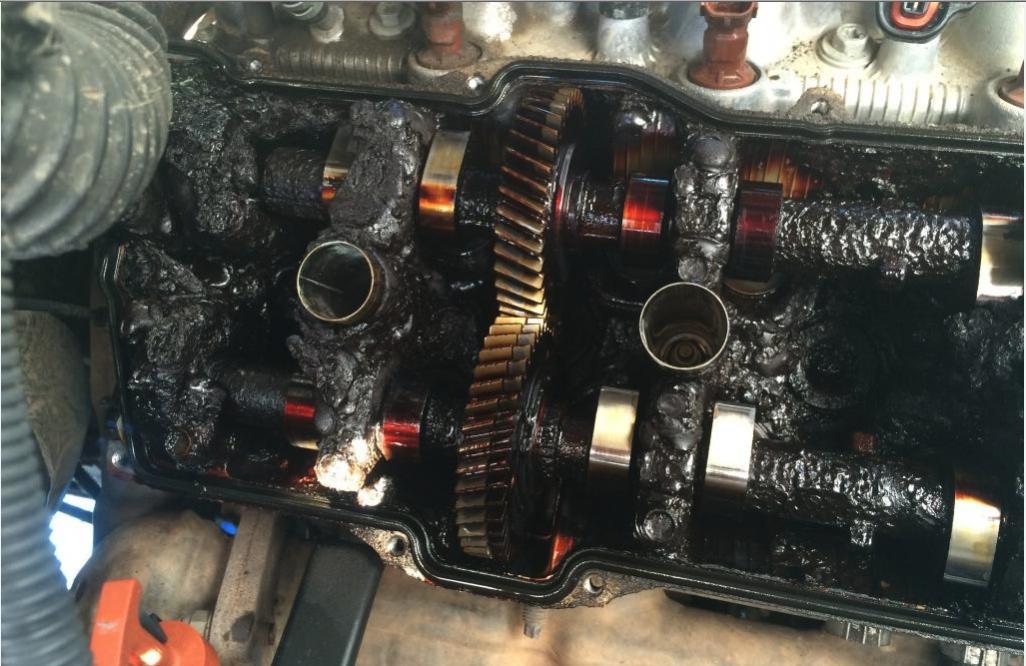

This is what sludge looks like
Photo said to be of a 5VZ-E engine, maybe Tacoma or 4Runner:
Engines are a little bit "dirty" by nature. It's controlled explosions. Is it really a shock that constant heat cycling of petroleum lubricants coupled with combustion byproducts produces a little bit of residue on a static surface? Now if your transmission is doing that, you have an issue.
Also, if you have sludge you don't touch it. Just change your oil. Fasting acting chemicals are exactly how you clog an oil passage. That's a much bigger threat than sludge.
