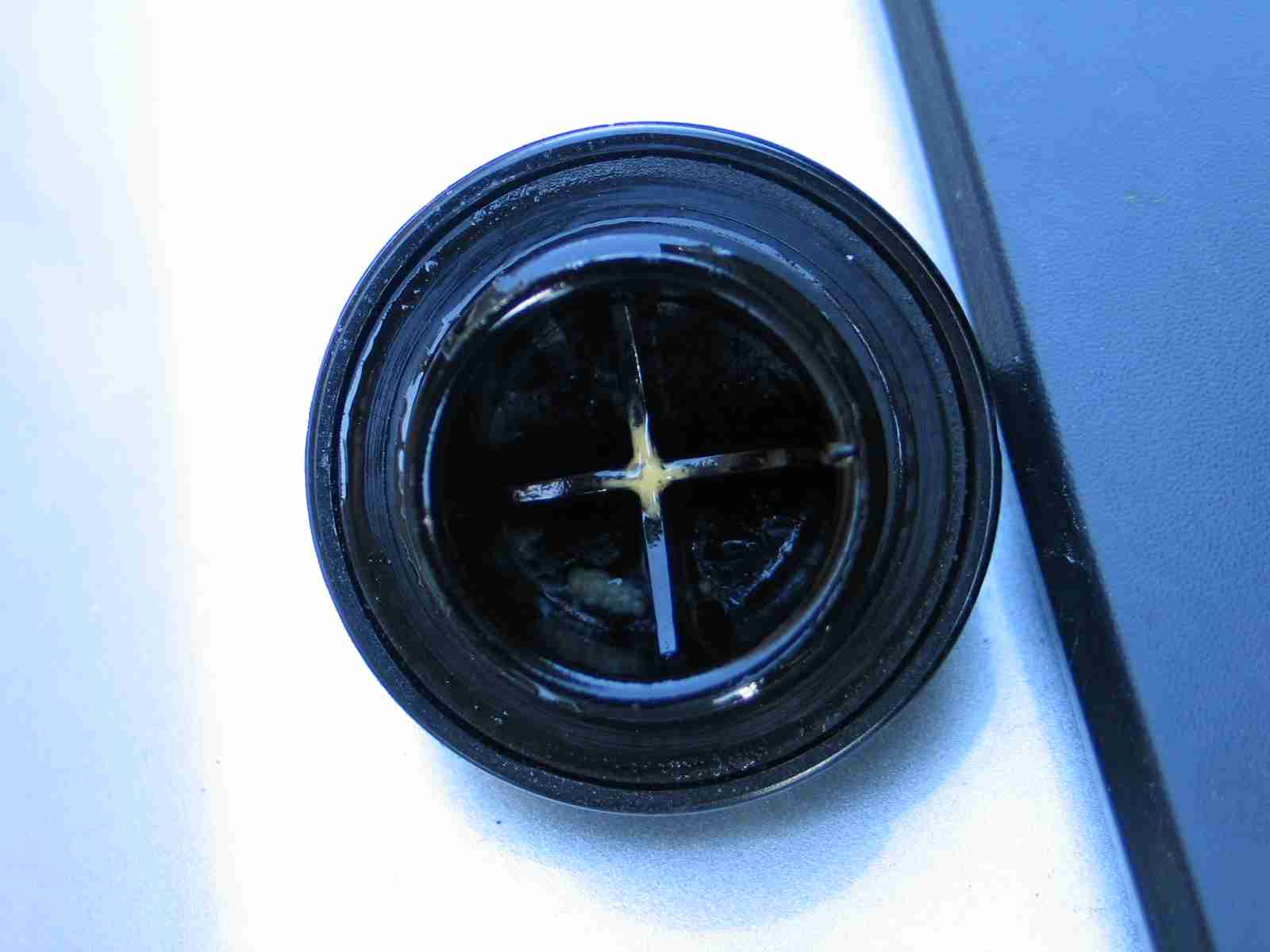

I has this problem too!;) Found it two weeks ago and took pictures last week. I just wonder whether there is some coolant leak, but coolant level is normal. My 05 v6 runner has only 5000 miles and uses Mobile 1. I plan to stop by local dealer to get check this satarday.
Yeah thats what that stuff looked like. Exept there was TONS more on our 4Runner.

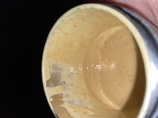

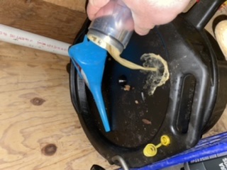

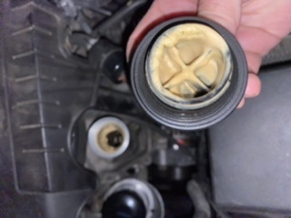

I have the oil cap sludge problem to an extreme degree in my 2008 4.0. It only happens in the cooler half of the year. I live in southeastern PA, the winters are variable but not extremely cold. I’ve had the truck for three winters and it’s always done this. A few weeks ago I installed a cheap catch can as an experiment, and after approximately 750 miles of driving I found a horrifying scene in the catch can.
This seems excessive even for an engine with a known tendency to do this. I have no idea why it seems worse on mine than other similar vehicles, but here’s what I know so far:
-A clean oil study with zero coolant detected pretty much ruled out a head gasket leak. Over 75k miles/2.5 years I’ve added maybe a cup of coolant, which I think could be attributed to the weep hole on the water pump or other undetected small external leaks. There are no signs of oil in the coolant, excessive pressure, bubbling, misfires, exhaust smoke, etc.
-Before anyone says “short trips”, I drove it 300 miles on the highway yesterday and didn’t shut it off for 8 hours. It still happened when I was commuting 200 miles round trip every day too.
-I use top tier gas, fill it up at 1/4 tank, and use heet gas treatment in the winter.
-I use synthetic oil, usually Mobil 1. I have heard that synthetics may be more prone to causing or worsening this but, again, others seem to use it without having this issue.
-I’ve changed the Pcv valve and vacuum hoses with Toyota parts several times. There are no signs of vacuum leaks anywhere. The pcv clearly opens because stuff is getting into the catch can!
Open to other ideas!

Jokes aside the froth is normal. Even if you allow the motor to reach normal operating temp, the residual condensation/oil mix from your shorter trips will still remain. That is the can doing its job, by preventing excess moisture and oil vapor from being dumped back into the system.
I have been running a catch on my 08 for a couple years now and have concluded the following:
-In colder temps (<30), you should expect to empty your catch about every 300 mi. (subjective to can size)
-In warmer temps (>30), you can easily get 1k mi or more between empties.
Most users should practice extra caution and empty frequently in the colder months as allowing it to completely fill and dump back into the intake could lead to much bigger problems.
If you are that concerned, pull the can and just hook the line back up directly to the PCV. Plenty of 4runner owners that experience cold weather and never install a catch. The vehicle will run fine either way.

-As for the catch can, I’m glad it’s working and my hope was that it would do exactly what it’s doing, I’m just shocked by how much gunk the engine puked out in less than 1000 miles. I don’t know if these engines have inadequate pcv systems, or need a windage tray in the oil pan to reduce the oil vapors, or what. But definitely a lot of oil and water vapors are mixing in the atmosphere of the engine. The gunk did not smell of gas.
