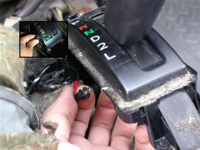

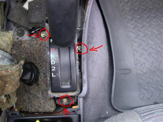

with the center piece off
and the actual bulb for 2WD(in the corner) and 4WD the big picture
