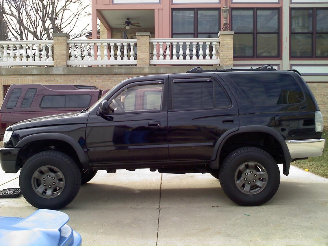

pics of the new tires for fun.
2012-12-02140106.jpg~original

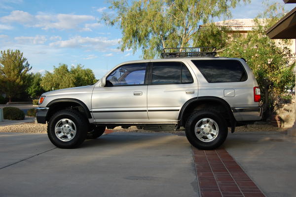

Yep. My 7 wraps (which were technically 7.5 and 7.75, but according to the color codes in the lift thread they are 7 wraps) gave me almost 5" of lift. And even after running weight in the back for a few months, they never settled below 4.5" of lift. So for op, thats definately not the rout to go. You can look in my thread and see the rake I had after installing the 7 wraps. The rake was ridiculous even with a 2" lift in the front
Edit:
As already mentioned, you will want to go with 906s, 99 coils, Ironman coils, Performance Products coils, or a body lift. Those are all small lifts. Tundra lift give around 2" in the front.
To show you the rake I had with the 7 wraps.
Thanks for posting the pictures. I do like the back end being a bit higher but based on your pictures 7 wraps with a 1 -1.5 inch lift in the front would be way to much. Will I get some rack with the 906's and ironman or 99's up front? I have read the 906's are not great for towing. I do not tow alot but we do have horse trailor that gets pulled around 2 or 3 times a year. I don't mind it sitting low while I tow just as long as it is safe.
