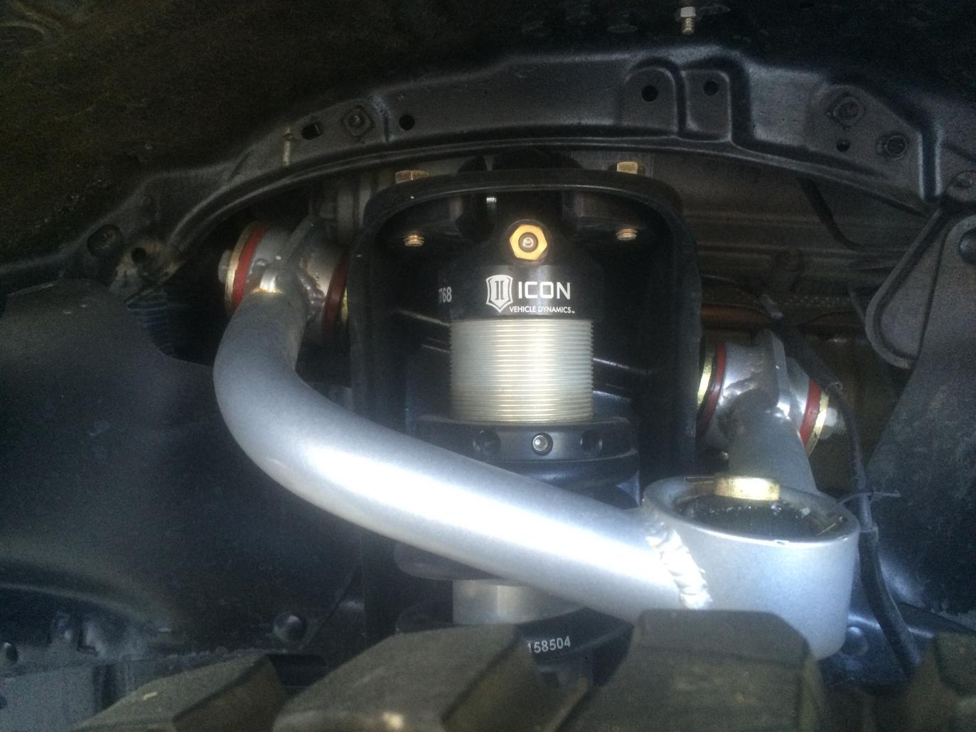

I have adjustable 2.5 Icon Extended travel coilovers on my 2005 V8 4WD 4Runner. Ever since I installed them I haven't been able to achieve the height I would like in the front. I almost have the maximum amount of threads exposed above the collar which I believe is 1.5 inches. It hasn't reached 3 inches of lift in the front and still has some rake. I think this is because Icon might use the same kit for the V6 and 2WD models which would have much lighter front ends.

What is the spring rate of your coils? Aftermarket bumper/winch? I believe most out of the box Icons come with 650# coils but I have seen a few with 600# coils as well. I have Icons on my 5th gen (650# coils) and it easily lifted it 3", you may need heavier coils. I think you can crank them past 1.5" of thread showing and be ok though.
you could slip a spacer in there to get a little bump, if you could find a spacer to fit the tophat. Its not the same shape as the top of OEM strut.
You also can crank the coil down a little bit beyond 1.5", issues arise when you've cranked it to less than the compressed length of the coil, then when it bottoms, the spring compresses on itself and crushes itself.
But, the correct way to achieve proper ride height is to suspend the vehicle with the proper spring. You need to up up your rate to a 650 or 700# spring. Easy to do, and then you did it right. It'll ride much better than a cranked down over compressed lightweight spring
Yeah, I have no complaints with my 700# coils + V8 and stock front bumper even. Need to measure how much of threads are exposed but I have a full 3" in the front.

You should buy icon or king coils in a longer length, like 14". This allows a taller lift with less preload on the spring. Just a thought.

Just like I stated, you run a taller spring. Stock icon spring is 13" I believe. They have an option to order with a 14" spring or you can order 14" springs from king.

Running taller springs will have the same effect on the CV as a tall spacer. The CV only cares about the relative height of the differential compared to the center of the wheel. That's why people with large lifts do diff drops.

Thanks for replies. I'd rather not put too much angle on the CV's so I'll ditch the spacers and I will try giving the collars a few more turns. If thats not enough I will begin looking for 700# springs if they don't cost too much.
Alright so my springs have number 158504 on them which are the 650# springs. The 700# springs are 158508. After measuring I have 1.75" of threads showing above the collar which is the max recommended by Icon. Would it be okay going to 2" of threads if I can even get it there. Measuring from the center of the wheel to fender is 22.5".
