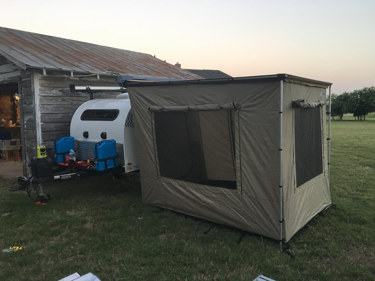

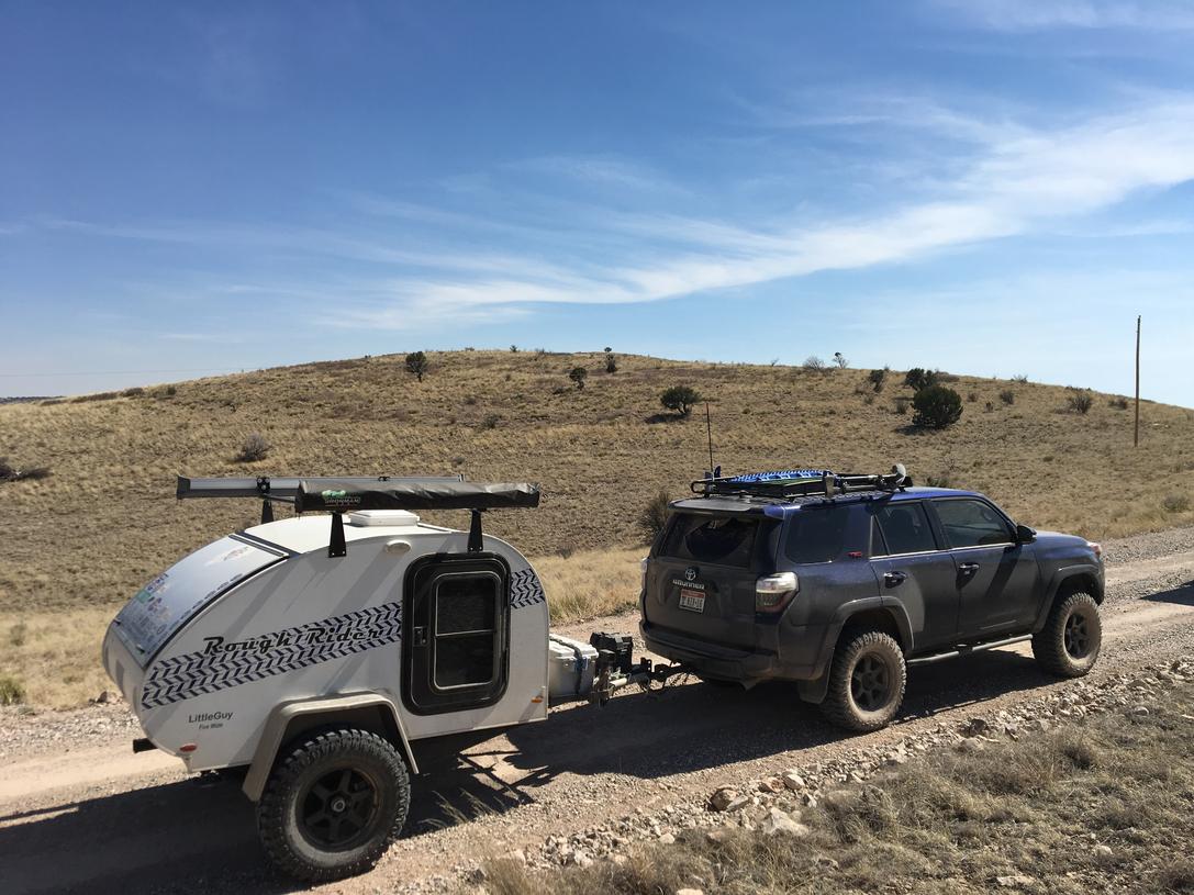

I love my little guy. It has an area in the rear that I can cook but also there is a queen size bed in it. It has been many places and has performed well. I lifted it using the Timbren system and then changed the hubs so I could use Toyota Wheels.
Good Luck

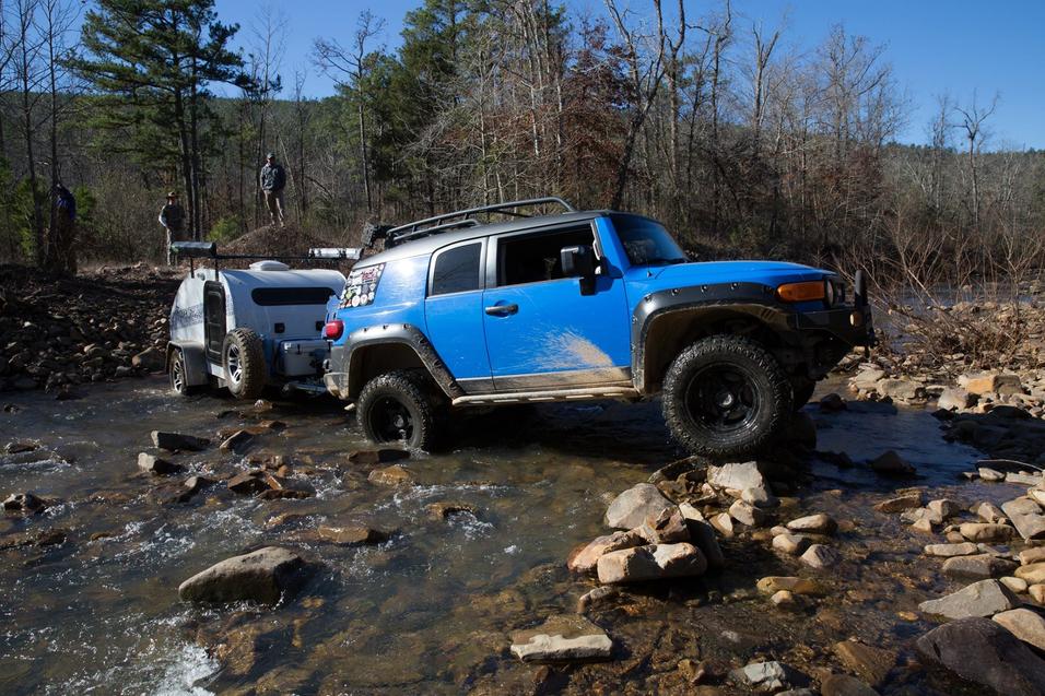

this was when I had the original torsion axel under it

Did you install the Timbren system yourself? Did you need to reinforce the frame at all ? How much for the new Timbren set up? thanks for any details

Yes, I installed the system myself. The instructions for the system suggest using either a square piece of tubing for rigidity, or welding the system up. I chose the tubing method. The price varies by application, however, if I remember correctly, my set up was roughly 650.00. Keep in mind I also changed the hubs so that was an additional cost.
