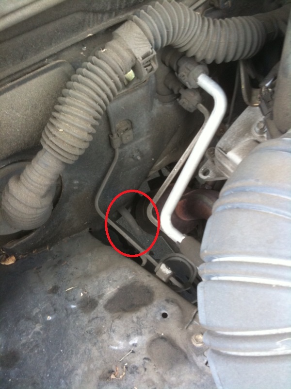

Can you get to the AC drain hose from the top or need to lift the car and go from underneath it?
You can get to it from under the hood on the pass side. No need to lift the 4Runner as it is right there. Here is a pic of the a/c drain hose:
