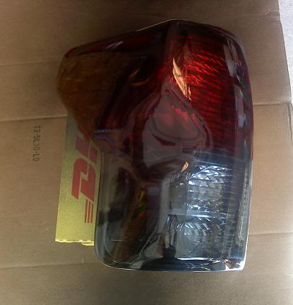

I actually have to disagree with the majority of most people. I for one like tinted taillights when they are done right. The wrong way of doing them is just spraying them with nightshades. The right way is masking off the main area where the light is emitted. Then do two light coats of VHT Nightshades in the unmasked area with wet sanding in between. Once your happy with the shade, go ahead and unmask the area. Then apply one or two light coats of Nightshades again, once again with wetsanding in between. Let those cure for a couple of hours then spray on a few coats of clear coat. Once again dont forget to wetsand. After thats all said and done, simply polish them up and they will look nice and purty.
Heres and example done on a tundra:

Don't want to go through that whole process. Sanding it then spraying it, nothing more nothing less. Thanks though, looks nice.

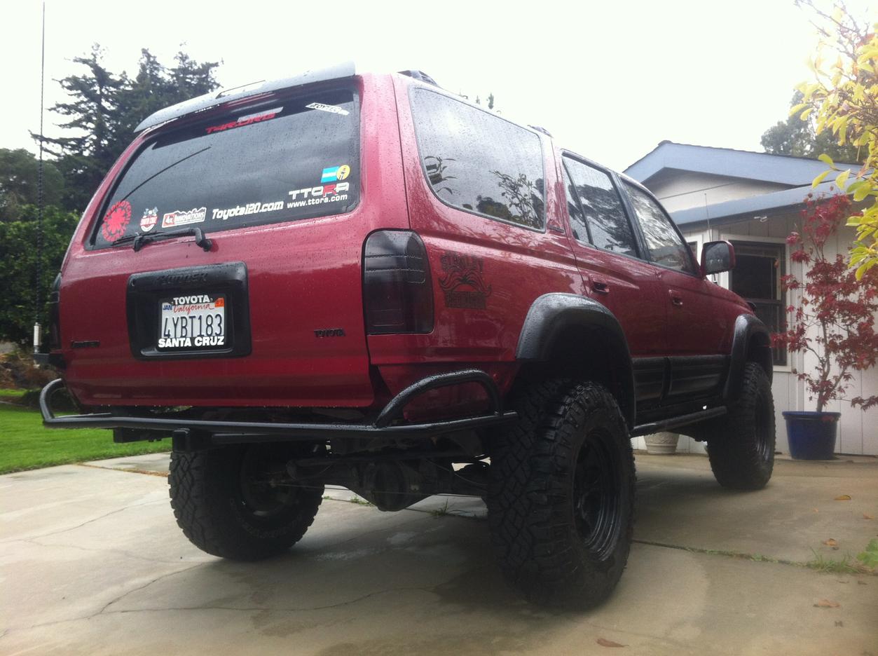

even being pulled over, still no flack for my painted tails, with night shade they dont reduce your tail light by very much. still perfectly bright. i have noticed a year later they are starting to fade. could use another coat.
for everyone giving you crap about not doing it. i dont think they realize how much light is still put out. go ahead and do it. i did 4 light coats on mine, be sure to be LIGHT coats. you can add but not take off.
sorry not a good close pic. but this is what i could find with mine
