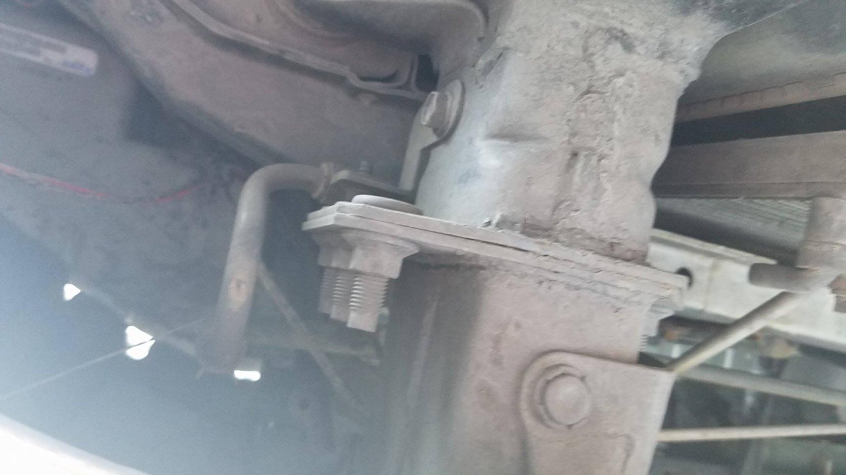

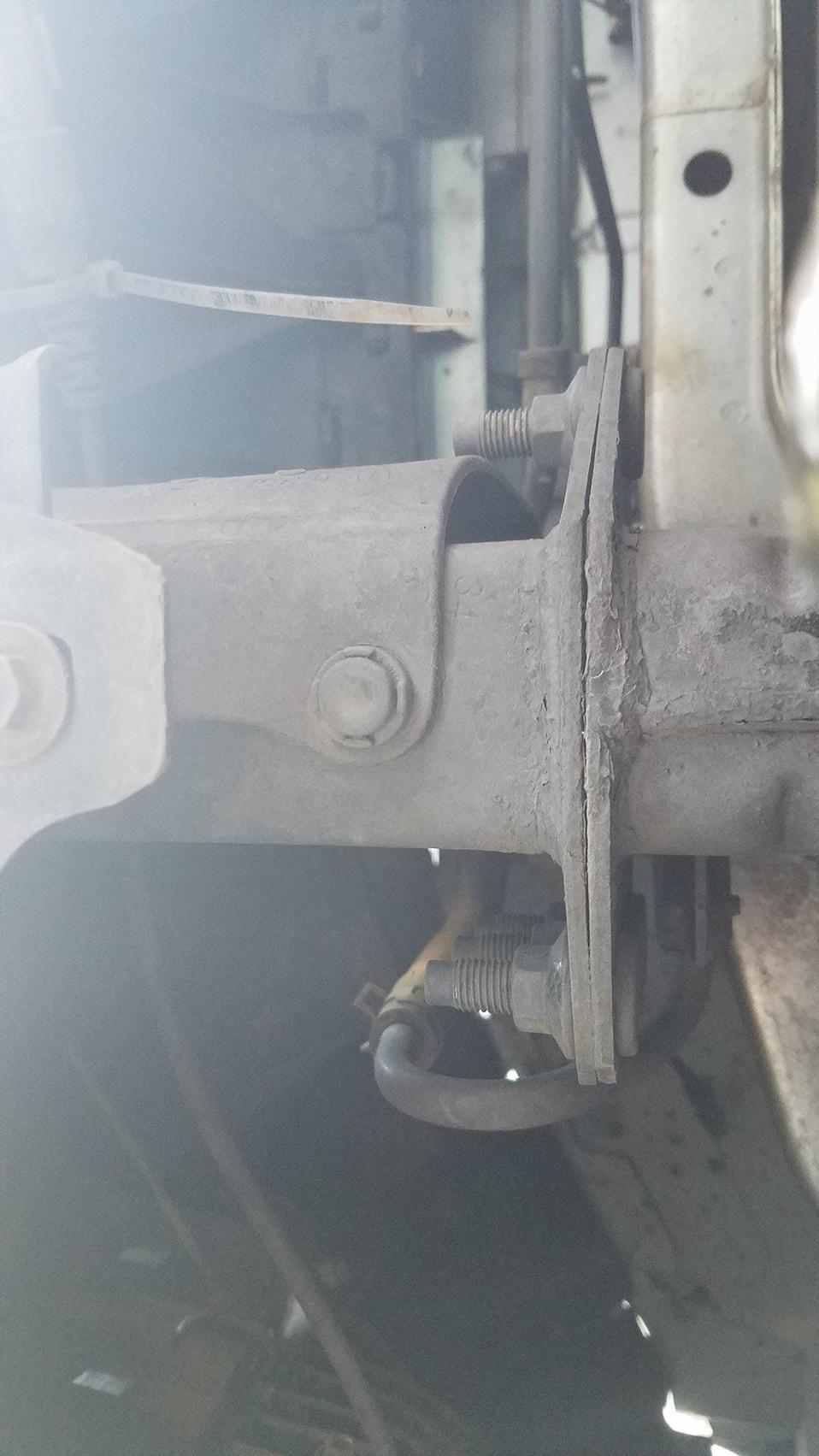

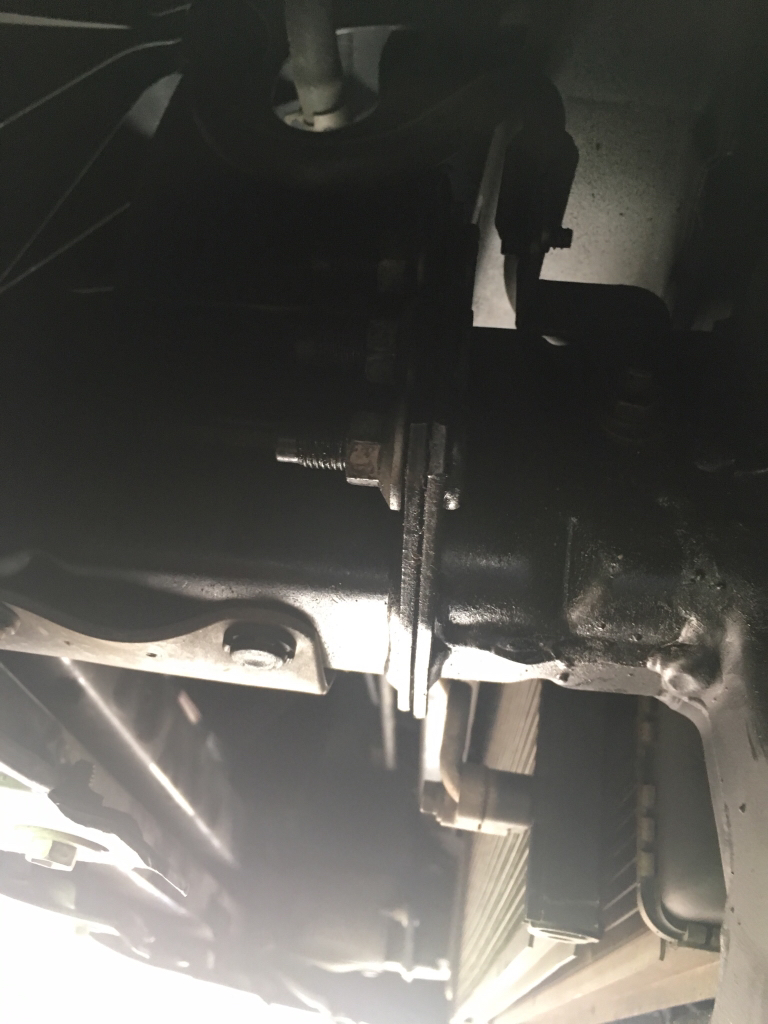

Here are the bolts at the frame/crash bar. I've chased noises like this at the dealer for days. You just gotta think outside the box on weird noises. Body mounts can make the same noise. I loosened all mine to make sure. Been driving mine for 4 days now or so with the crash bar/frame bolts slightly loose. No Noise whatsoever.
alright im doing this next.. will provide status update once complete
There are 4 bolts total each side. 3 on the outer of frame and 1 inner for each side. Just back them off a few turns and see what happens.
Well I loosened these bolts and just made sure there were snug but not to tight. Maybe the noise changed maybe it didnt but its still there. I also notice it when I stop. Where do you think that crash bar is rubbing to make that noise? I rolled around under the truck checking random bolts and things that could possibly make that noise and still cant find it..
Next idea is either u-joints or Lower ball joint.
