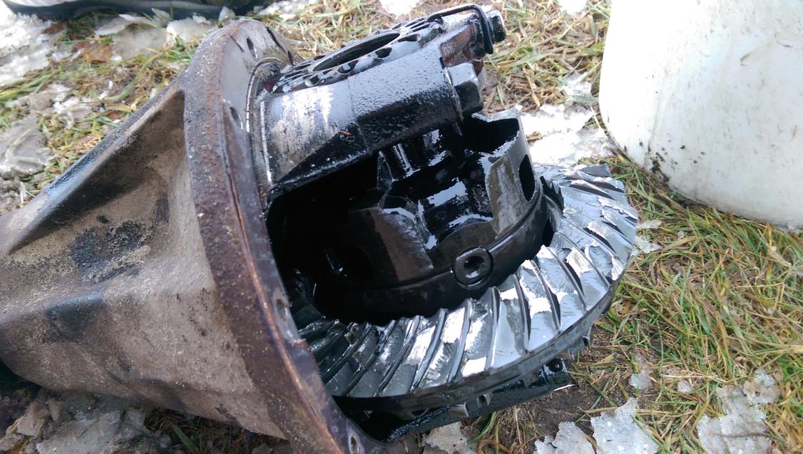

When I say they grab hard, I mean it! I broke my rear ring and pinion pulling my buddy out. I was going uphill in sand! Which brings me to my next thought, if you haven't rebuilt your front and rear diffs yet, do it. You need to get rid of that crush sleeve and put the solid spacer in so you don't do what I did. Here's a pic of my ring and pinion ;) Took the teeth out almost the whole way around! Of course I have a little more power than yours, but still. If you drive it hard, do yourself the favor! :girl:
