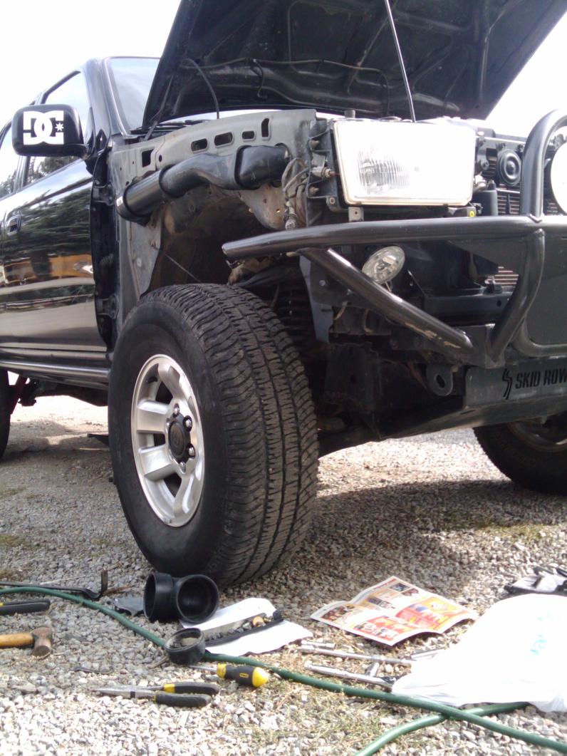

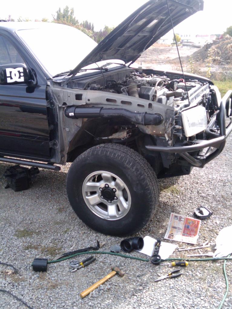

im currently doing my internal snorkel right now, but what im doing instead of what the 10 one is im using the existing tube thats already in the fender to do it, and im liking the way its turning out its quite easy this way if you have the "taco tube"
im doing this also is because i was going to run into a problem, i dont have fiberglass fenders so i was going to get that big joint to fit in the front and the rear i cut the whole bigger to fit half that 90 degree joint into the cab instead of having a little pipe like the write up.
hope this encourages others to try it :)
