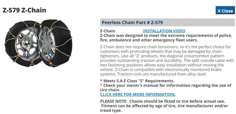

Peerless Z Chains. Easy to install, no tensioner needed.

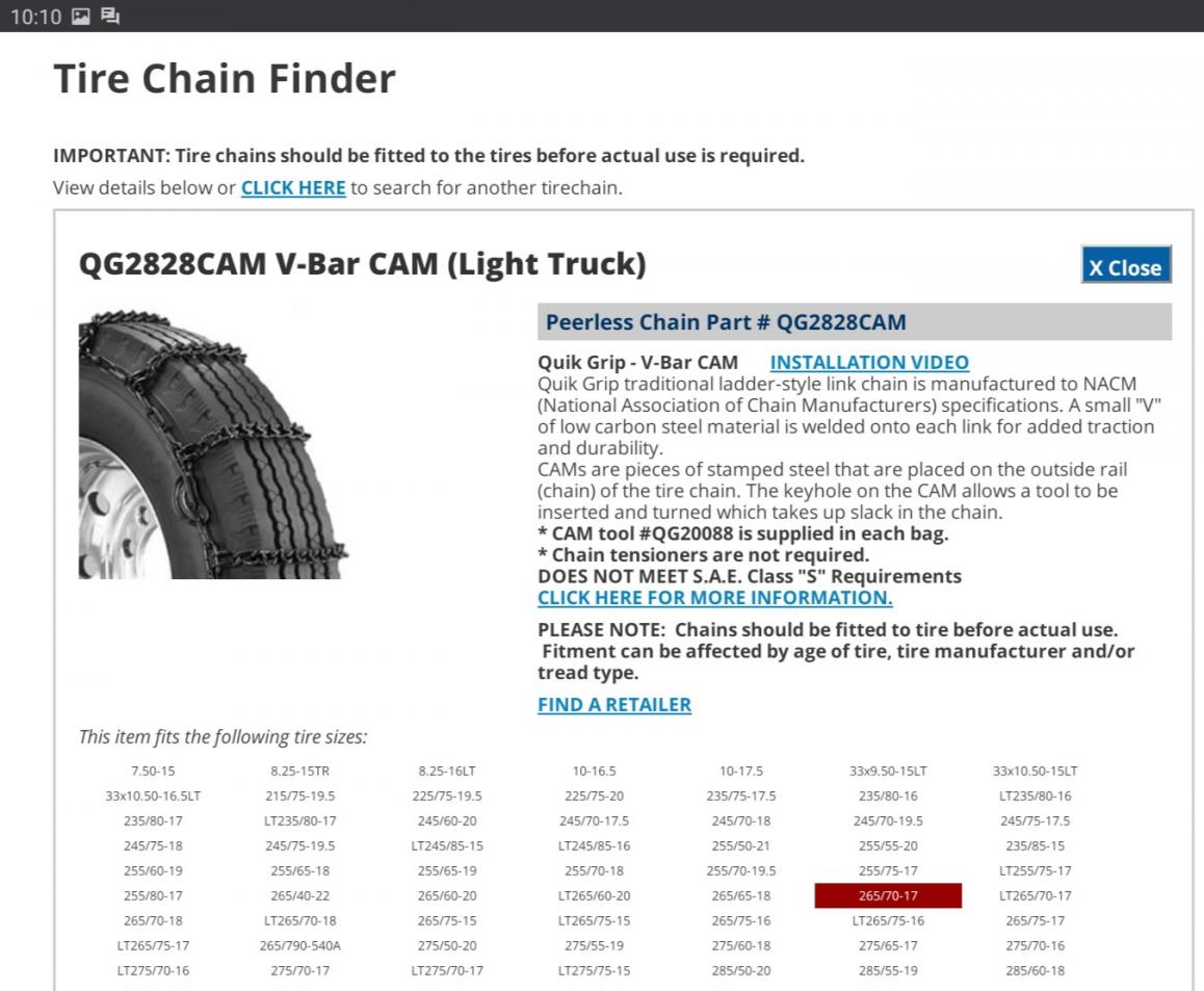

If you need more than the cable chain I posted earlier,
