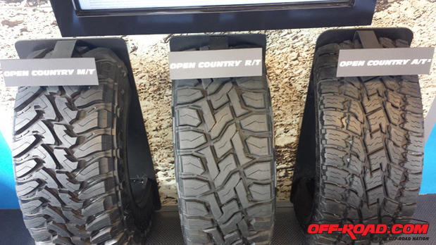

Although we may be violently agreeing. :peace: I think there is one important subtlety here that is my point.
Forget all talk of chains and studs for a moment. As winter tires, summer AT/MT tires generally bad. They are made for off road durability and grip in loose material, with massive lugs and spaces that clear easily. E.G:
This means in most winter conditions, except perhaps a heavy snowfall with no ice or hardpack underneath, they tend to suck:
-The rubber is hard in low temperatures since they are generally made for durability, thus reducing grip on all surfaces including ice and causing the tire to conform less reducing contact area;
-The large lug spaces further reduce contact area on surfaces from ice to dry (but possibly 25 below) pavement; and
-There is generally little to no siping that is critical for grip on many hard surfaces, particularly icy or wet ones.

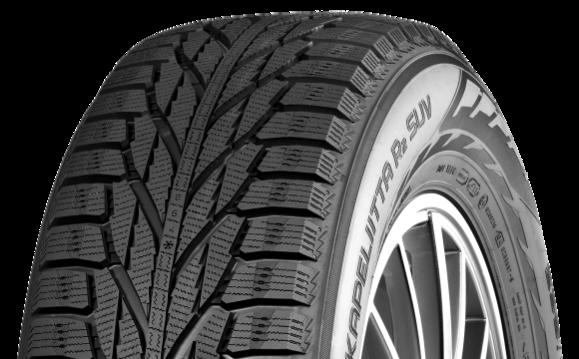

Here is a proper non-studded winter tire for comparison:
Note the large amount of siping, greater contact areas, and (what you can't see) the softer/low temperature rubber compounds.
I am trying to get across that for broad winter use you don't want MT/AT tires at all. The ability to stop and chain them up is moot. You aren't going to stop and chain up except for the very odd event. You need proper tires all the time because there is often ice and hardpack everywhere and/or anytime. Even with out studs proper winter tires have far superior grip on ice without having to break out the chains. Leave the MT/AT stuff for playing around off road in the summer.
Now apologies if you also agree completely with this. It just seemed to me you were suggesting that AT/MT tires with chains in the back seat were a viable option for anywhere with actual winter.
