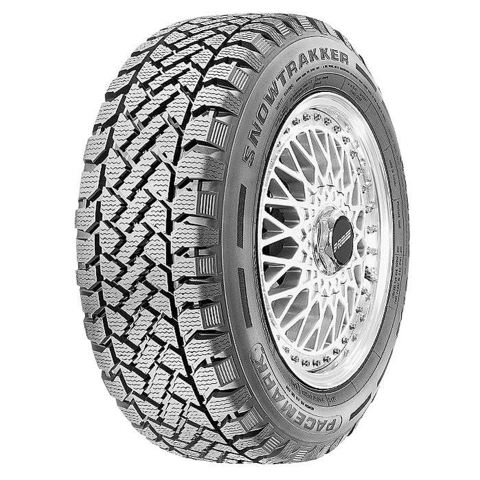

Anyone know about this one?
Snowtrakker...
I can get a set of 4 put on for $360 out the door...
Not a lot of reviews out there from what I can see.
Thanks
