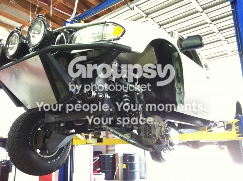

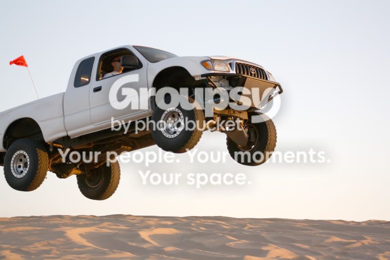

Well, that depends on a couple things... Mostly how much air you're looking to get. If you're talking Huck Fest type stuff like my buddy PismoJoe here, you're looking at getting some long travel type stuff going. In this pictures he's running a Total Chaos/King setup, but now he has a pretty sexual looking Icon setup.
f1b21a88.jpg~original
IMG_2579_zps4493bcc4.jpg~original
If you're talking about just getting the front, maybe the rear, off the ground a few inches, maybe a foot, you'll be fine with any 2.5" Coilover, I imagine, but I highly encourage that you make positive that you've clearanced your fenders so that you don't come down, stuff a tire, and damage anything it hits under there.
I learned that lesson the hard way.
Now that I have 100% clearanced everything down there, and upgraded my bump stops to the Wheelers Superbumps, it honestly feels better than hitting a speed bump when I get a little air under the tread.

That trucks pretty awesome! Yeah, I would only plan to ever do a couple wheelies, nothing like what you've pictured.
