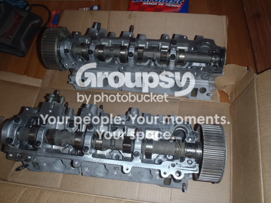

I bought a 94 v6 runner with 215k for a grand last week. It had a miss fire. so I started with plugh, then wires, then dist cap and rotor,made sure it sat a 10btdc. It was still running like crap so i started pulling off one plug wire at a time to see what cylinder was missing. lo and behold #6 and #3 where not firing. so i pulled the plugs and ran the motor with the two plugs out and couldnt see or small any gas. so i replaced the fuel injectors and all of the seals. And what do you know it still ran like crap. After a few hours of research i find that #6 cylinders head gasket is a known problem and 3-4 is problematic as well. so i Bought an eristic complete top end gasket kit and pulled the motor apart to find .050 new pistons, fresh cams, new head gaskets, and no visible signes of wear. no carbon build up,and nothing visibly broken. Im still going to bring the heads to the local shop to have a once over. with all that said i need some help, my dad seems to think its something electrical, and now after regreatfully pulling the motor apart Im starting to feel the same. any advice would be helpfull bear in mind that it runs almost the same with the old and new wires, plugs, cap,and rotor. the two new injectors helped a little bit but not much. One last thing has anyone here used eristic gaskets? if so where they any good. the head gasket that was on the truck seemed to be made from a stronger material. basically what im asking is what brand head gasket should i go with?
Well i have the heads at the local shop and the guy there is going to completly rebuild them for 200 bucks. he gave me a nice discount because my girlfriend and his wife are good friends. he told me to trace the injectors wires all the way to the computer and make sure there are no visible damages to them. On top of that im going to clean the upper and lower intake manifold, put on a new fuel filter, pressure test my exhaust, last but not least replace all of the hoses under the hood. I have some pics up as the progress goes on.

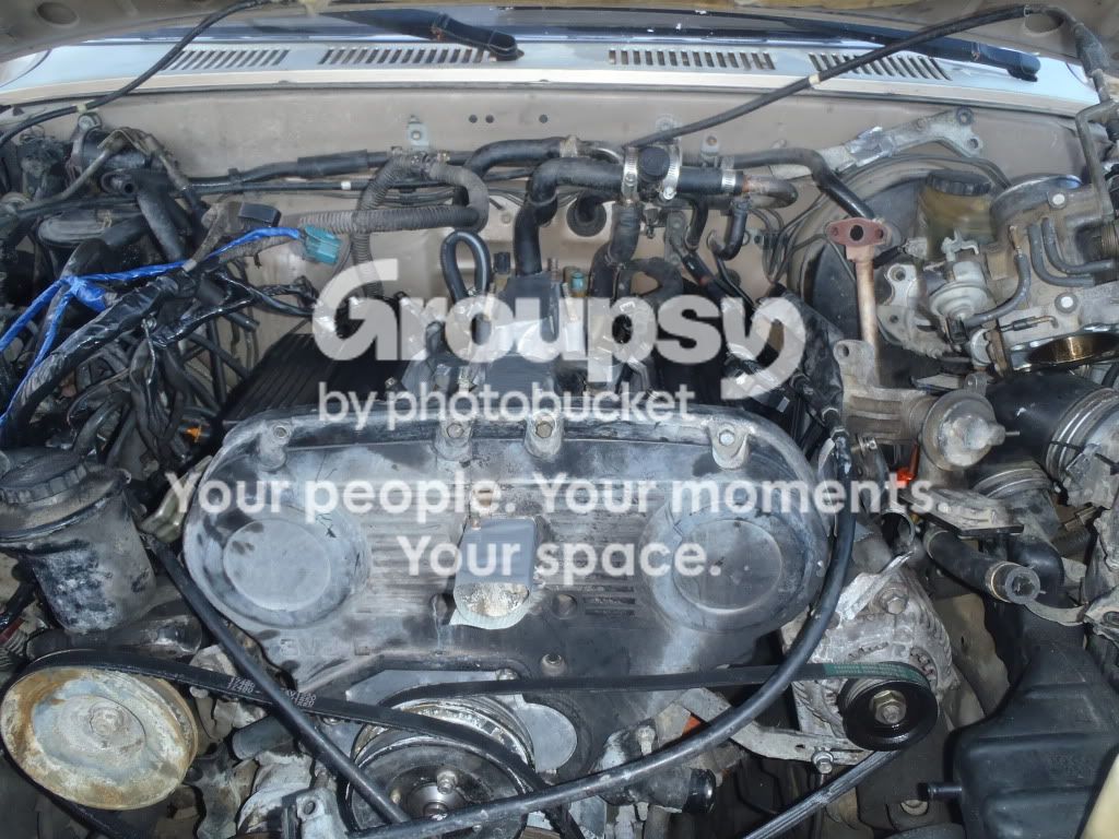

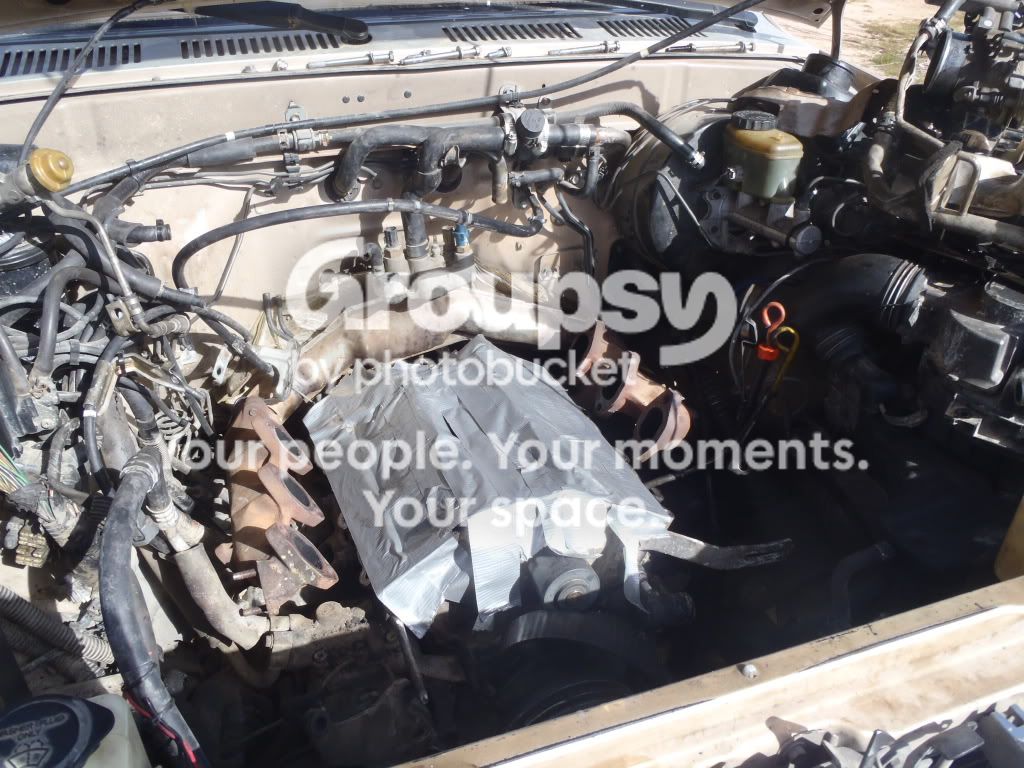

This is the engine bay as of right now

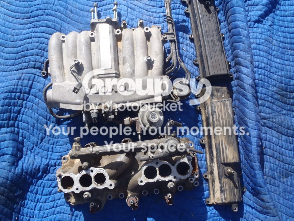

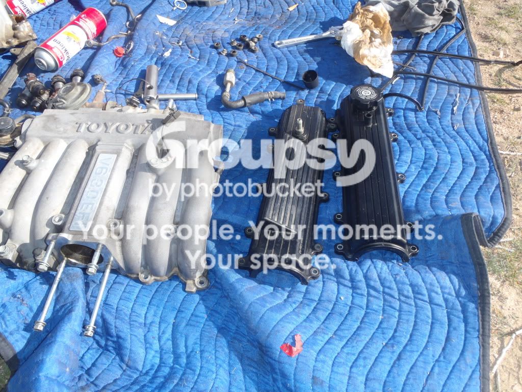

some parts im cleaning
4runner002.jpg~original
The hard to see progress......lol the lower intake was to caked so the local shops going to hot tank it.

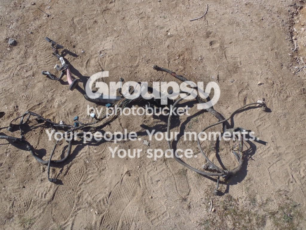

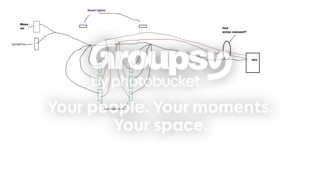

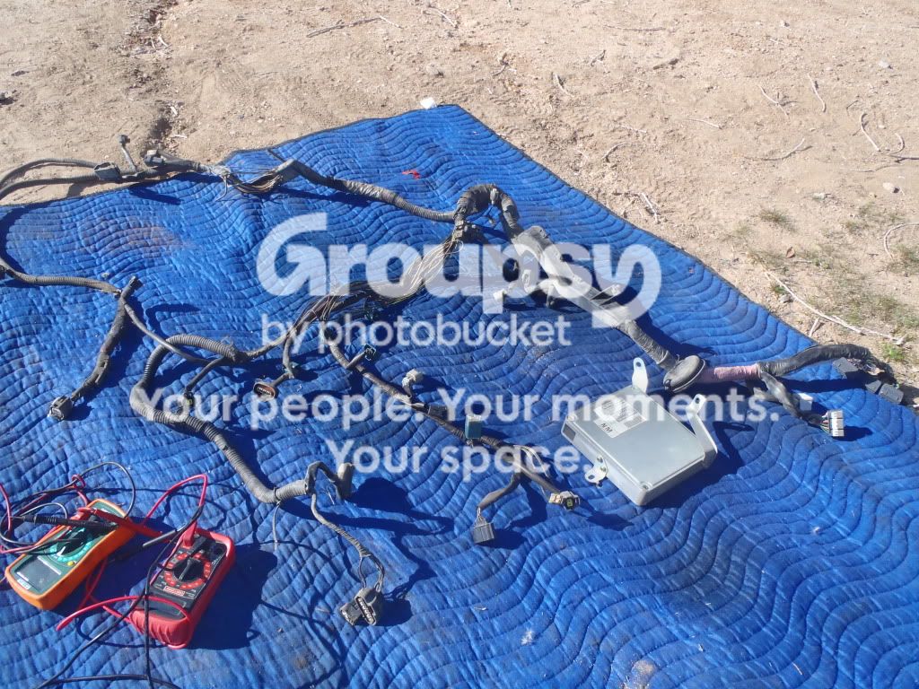

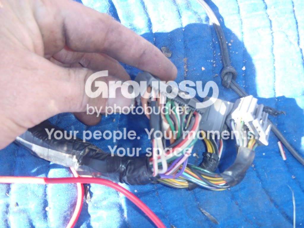

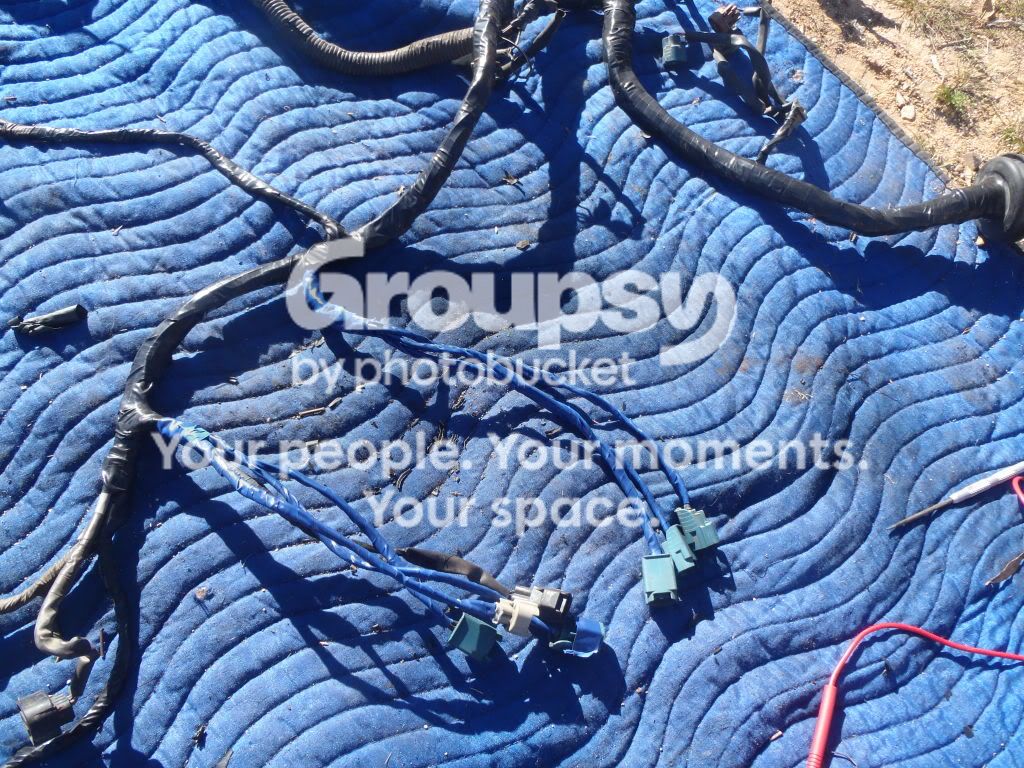

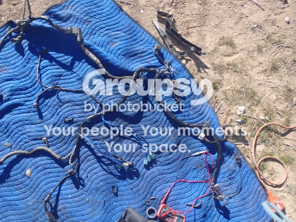

Todays update! I pulled the harness out of the truck, it was much easier than i expected! once i got it out i stripped all the tape and heat shield starting at the injectors to the computer. i found the injector wires where cracked and missing insulation so i replaced them to the factory wire split. What I found out is by design all 6 injectors spray fuel at the same exact time. At first i thought someone might of rigged it by connecting the two wires but when i took the screws off of the top of the ecu i noticed that both pins are linked by the circuit board. i drew a cheesy little diagram. my question to the timing on the injectors is would it be possible to make them fire when the intake valve begins to open vr all of them firing at the same time. and if so would this increase horse power? any who i have the harness back in the truck and im just waiting on the shop to finish so i can finish her up. oh i also found myexhaust leak. a gasket was not installed on the passenger side, where the header meets the back pipe.
Cheesy wiring picture, i drew the head lights so you get the idea of front and back

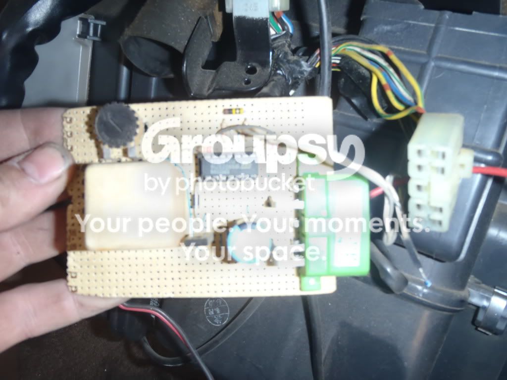

A mistery unit, if you know feel free to speek up

the wires with the black tape go to the injectors ones for the laft bank and ones for the right bank but they are linked about 4 inches in the harness and inside the ecu

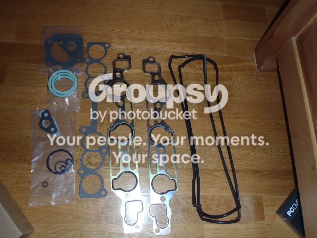

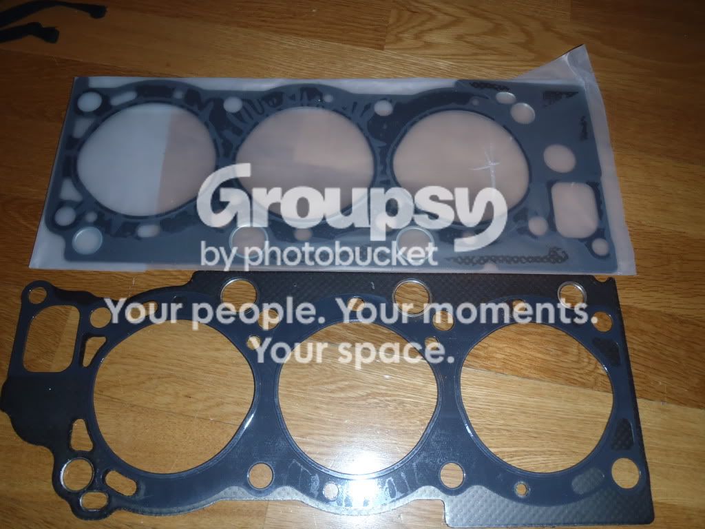

Today i dropped off my lower intake so it can go through the hot tank. I also brought the eristic gasket set with me and the owner of the shop said the gaskets look better then felpro and he would not hesitate to use them. tomorrow everything should be ready for picup.
here are some pics of the gaskets just for something new to look at.

What is that mystery board hooked up to?
As for messing with the injector timing, I wouldn't mess with it. They are all supposed to spray at the same time.

ill replace the coil. i just wanted your viewon how it could be the problem. the mistery unit plugs in to the clip next to it in the pic. its part of the hvac harness.
The only way I could imagine you could modify your injector timing is through a stand alone fuel management system like Megasquirt or other system. Not sure if it would be worth the effort, but you would have much more control in regards to tuning it for air/fuel/timing.
The gaskets do look good, I was a little worried about that but they seem to be of decent quality.

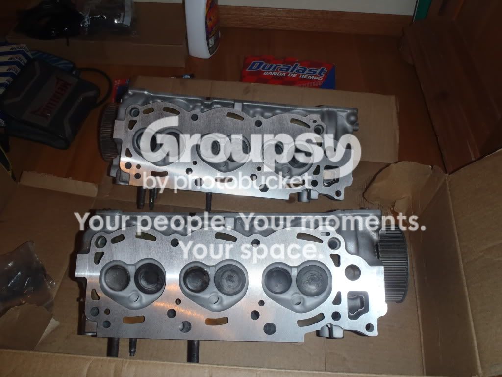

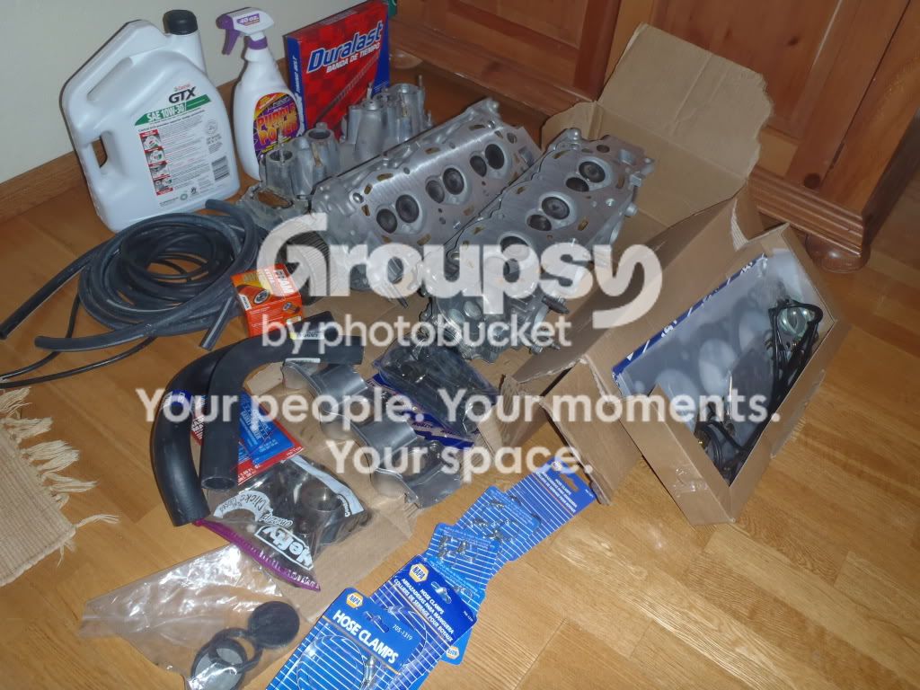

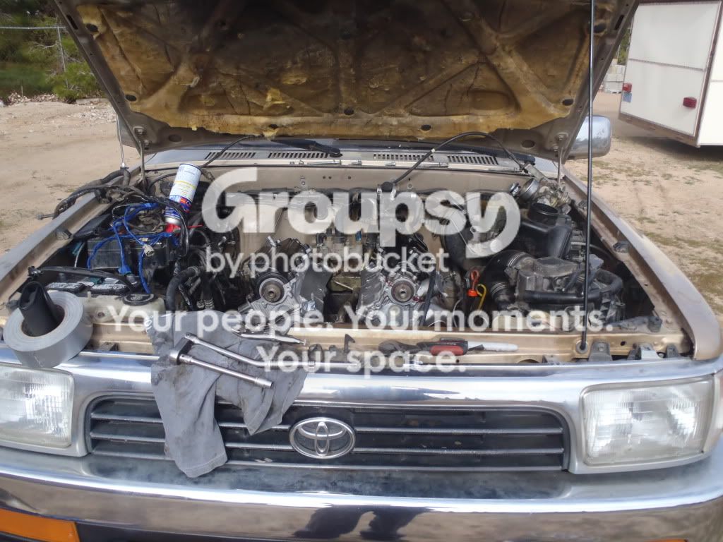

Great I have the heads and lower intake, except now it looks like rain out today. Hopefully ican get the heads and valve covers on befor the clouds open up. here is a pic off all the stuff i have for it as of now, I have to make one more autozone trip to get the belt componet set and new fan, alt, ps, ac belts.
heads

all the goods

Now i just have to get my ass in gear
It hasnt cost me a lot for everything, im under 500 right now!

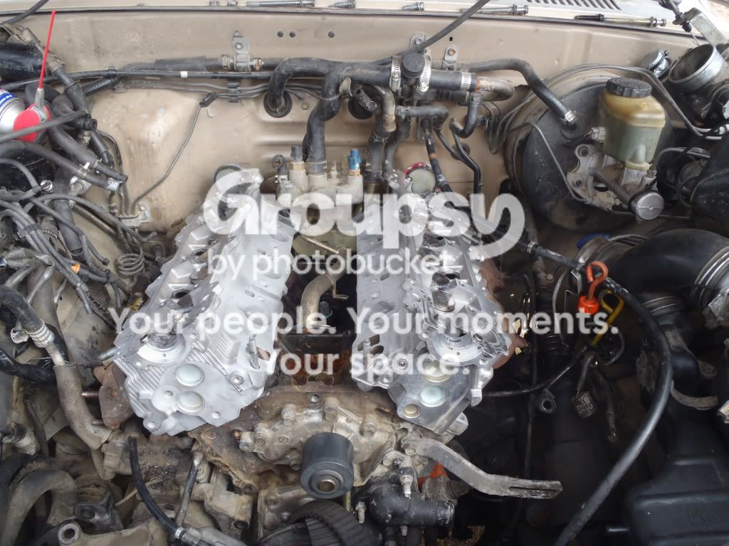

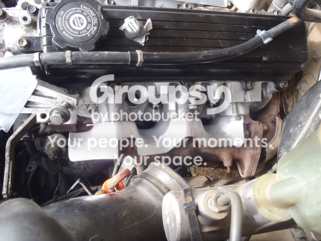

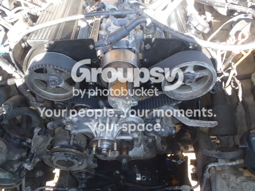

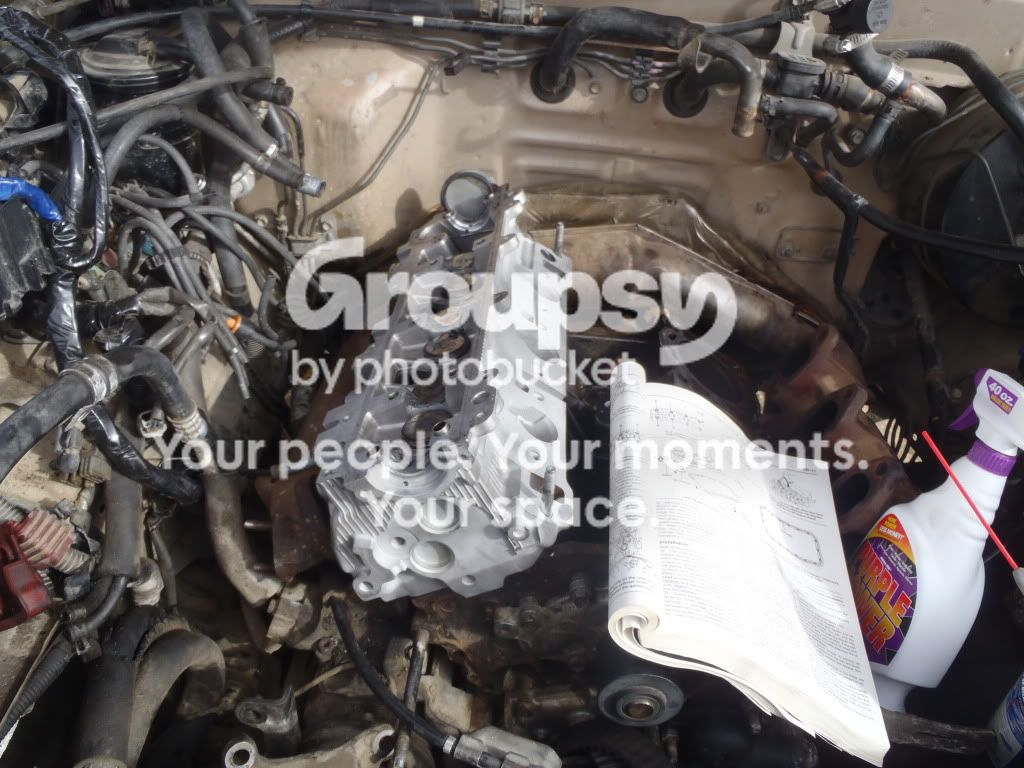

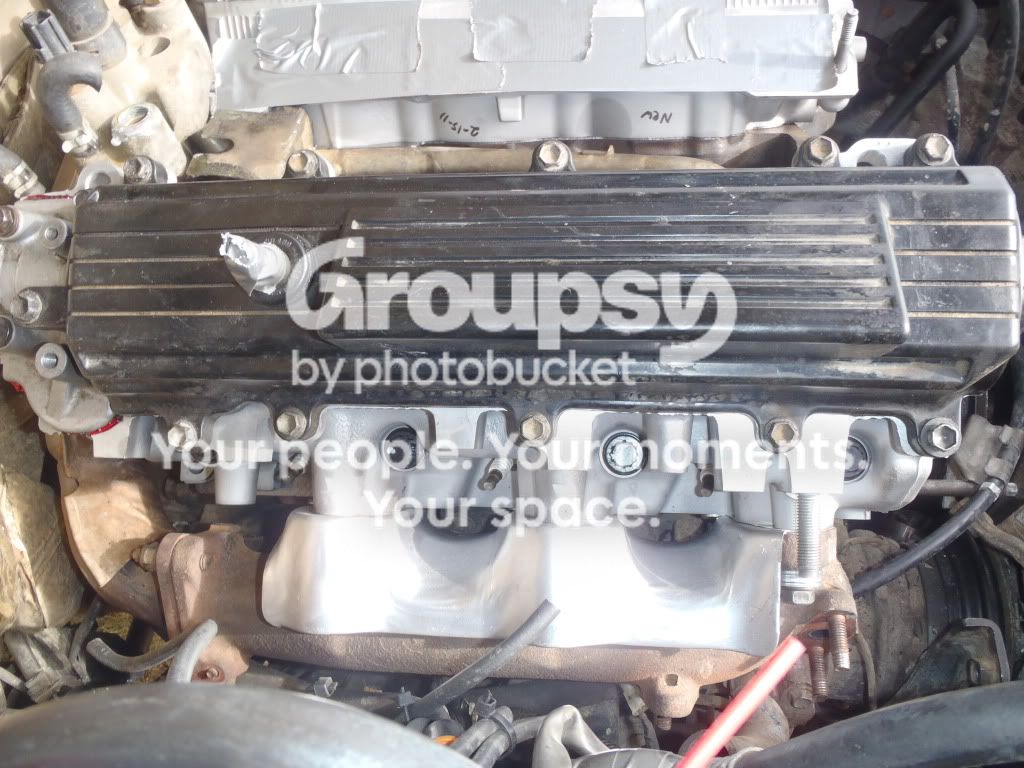

So after *****ing about the weather i decided to do some work. I have the heads on, exhaust on, and valve covers on. everything has high impace grease on the moving parts so it has lube until the oil pressure builds.
I dont have the timing done yet, i still have to fix a bolt and a stud and get the knock sensor wire clip out of my girls truck. hopefully i can do more tomorrow.
1st head
carrebuild001.jpg~original
both on
carrebuild003.jpg~original
carrebuild007.jpg~original
carrebuild008.jpg~original
