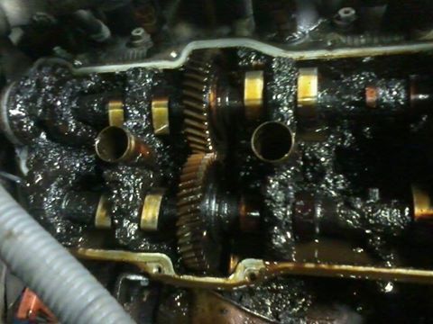

Recently bought my 4runner, only to discover that previous owner hadn't changed the oil in so long it clogged up in the heads like dirt. The mechanics told me flushing out the motor was no guarantee that they could get out all the chunks, and basicly the motor was toast.
