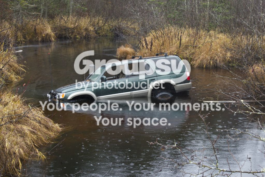

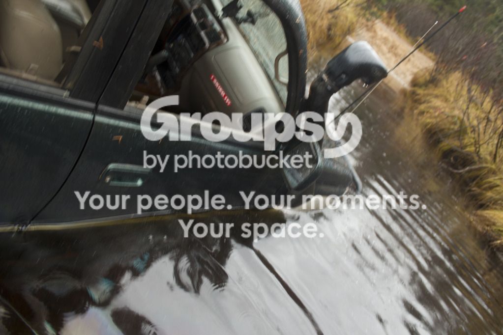

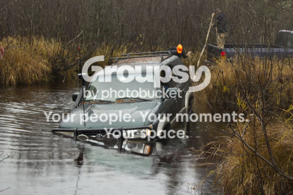

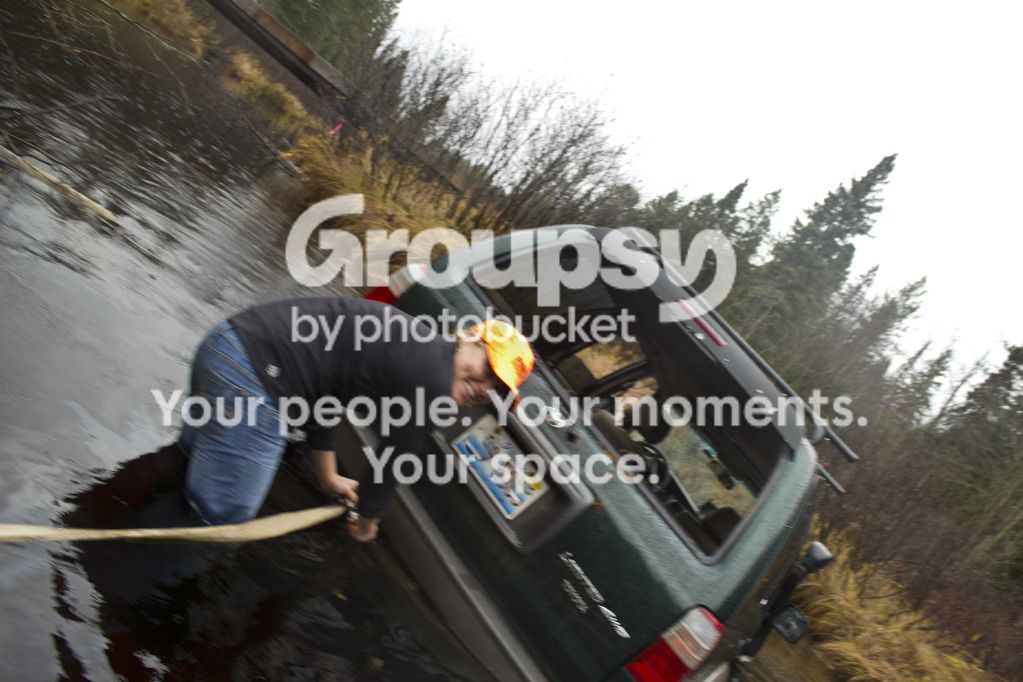

Decided to go do a little hunting up in my favorite spot, wanted to get across this creek I'd been across many times before, but this time was different, hesitation on my part due to higher than usual water levels, and the higher water levels themselves led to me getting stuck trying to cross.
Of course I was alone, my winch was broken, and I was totally unprepared for a recovery. I was at least a 45 minute drive to the highway on poorly maintained dirt roads, and probably 30 minute drive to the nearest house. This place is the middle of nowhere. Luckily while I was trying to self recover, my friend was able to get word out to my friends in town to send a recovery party, and find a fellow hunter to drive us out to the highway.
Regardless, from the time of first loss of momentum, to the time where the runner was actually pulled out of the frigid water it probably sat idling for 3 hours.

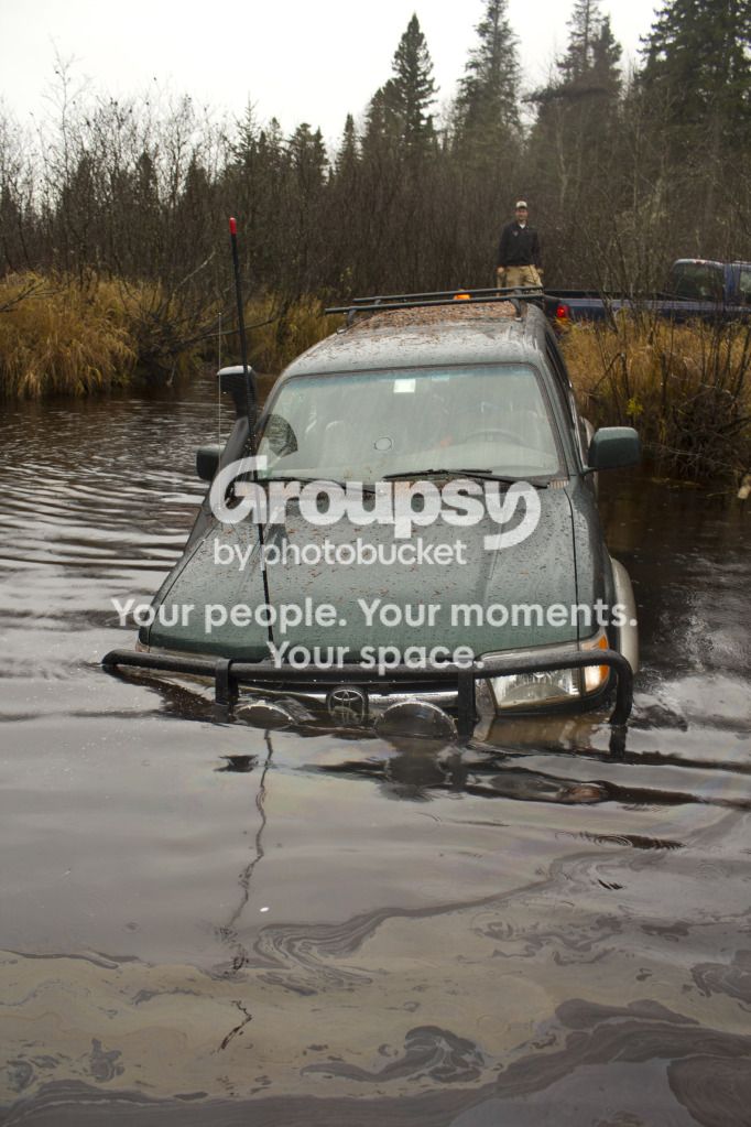

This is the shallowest...

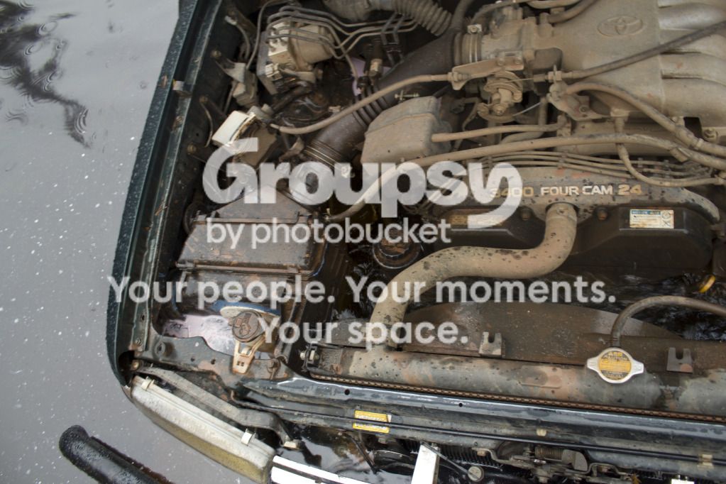

The observant may note the strawberry colored foam towards the back of the engine... More on that later.

So the runner was idle this whole time. I assume it was running on batter for a good portion of this, because my gauges showed low power. After being yanked out, it almost didn't come out.... It was backed up this hill possibly 500 feet, turned off, inspected, finding of course water in everything, tranny, engine dipstick, headlight, air box etc. It was then decided to tow it out to town, the trailer it home. Due to poor parking, I actually had to start it after this to get my wheels turned, and she fired right up!

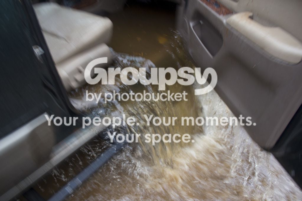

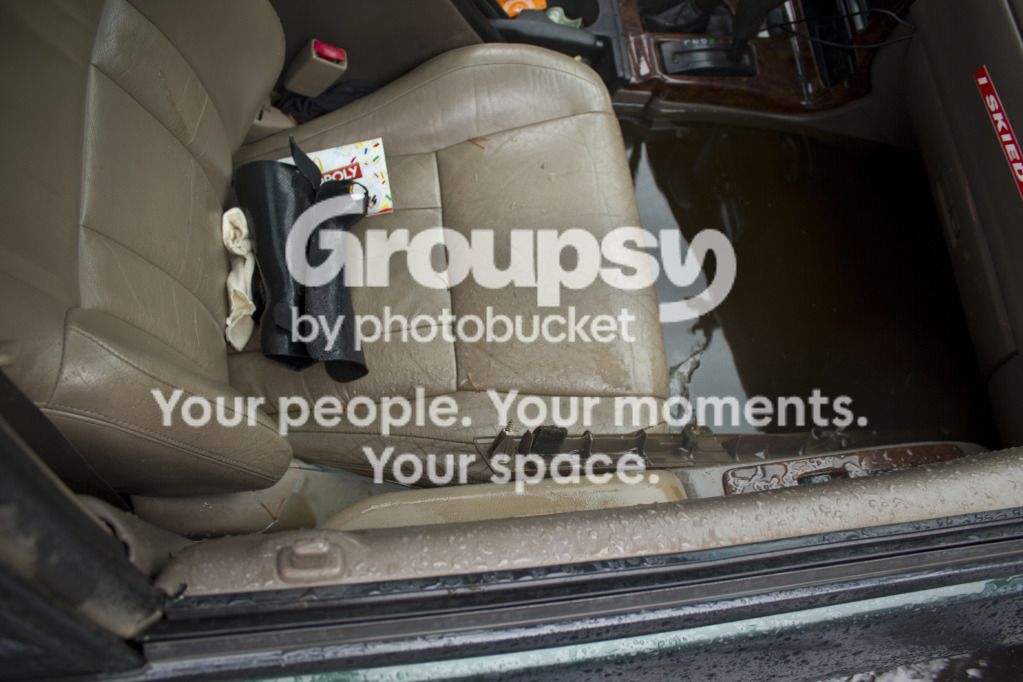

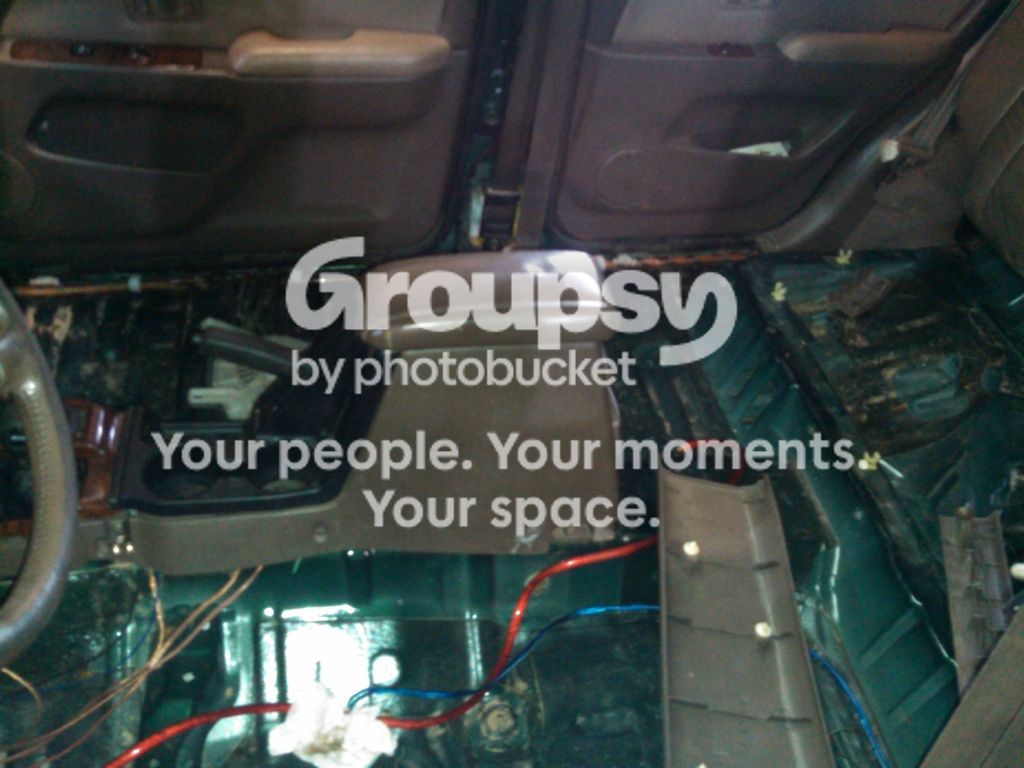

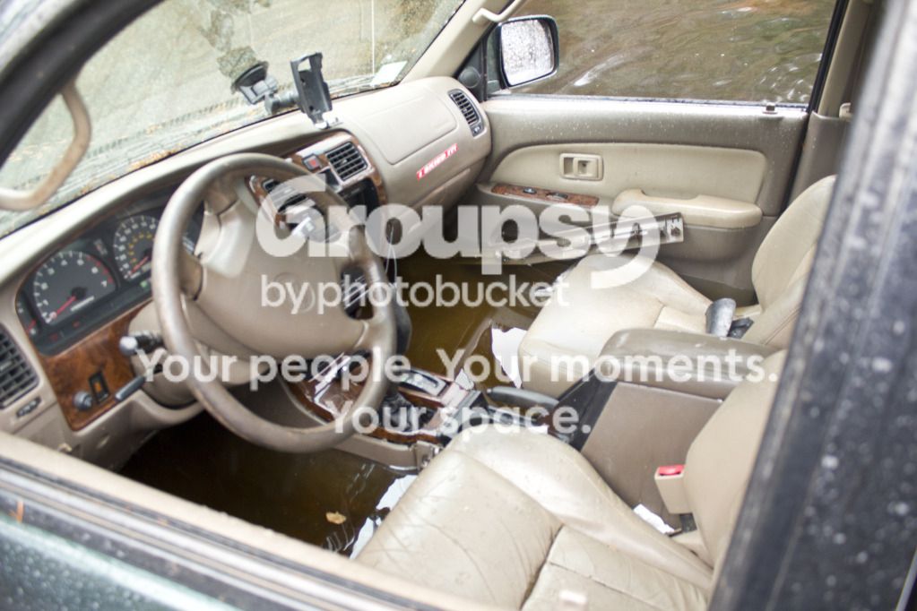

No more interior...
IMG_20121019_093112_519-1.jpg~original

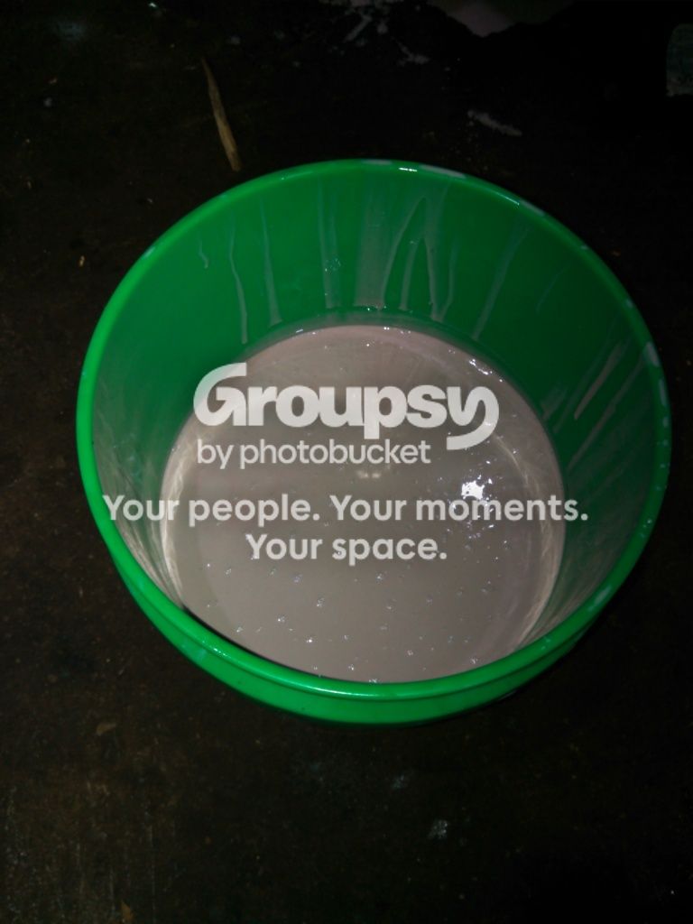

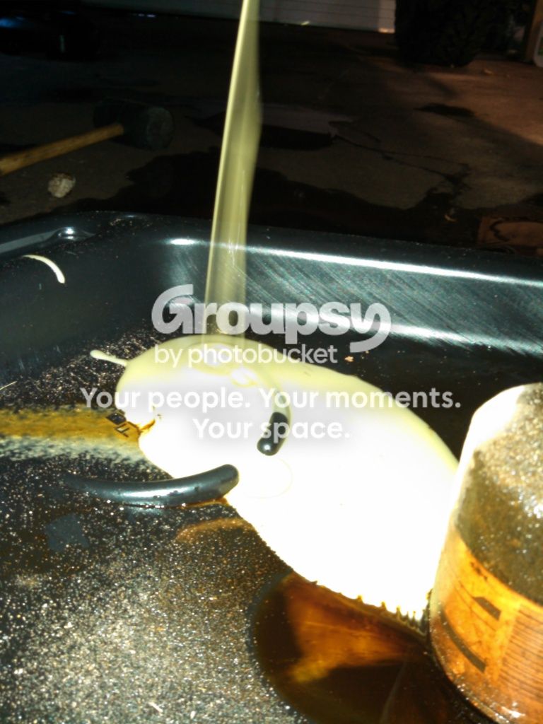

What came out of my tranny..
IMG_20121019_242958_204-1.jpg~original
IMG_20121019_243008_904-1.jpg~original

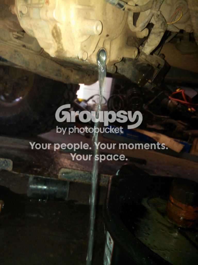

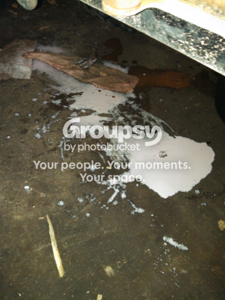

This came out of the FILL PLUG of my front diff.
IMG_20121019_091220_165-1.jpg~original

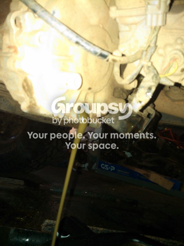

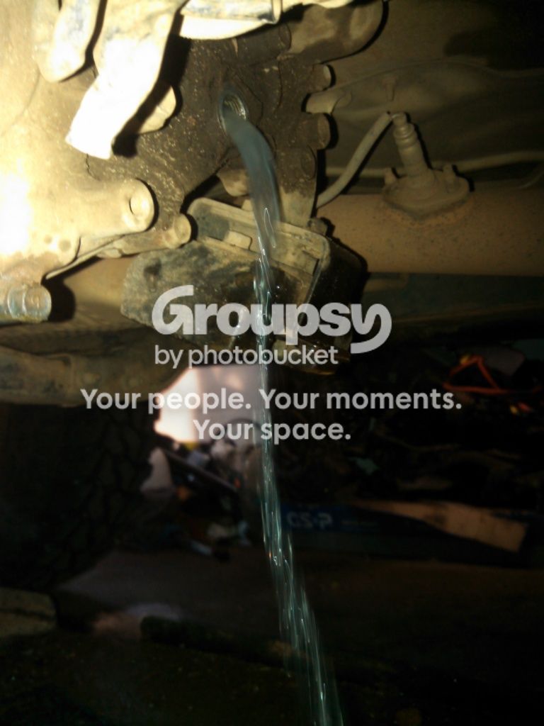

And this came out of the FILL plug of my transfer case for about 2 minutes
IMG_20121019_092224_055-1.jpg~original
Then this came out of the drain plug
IMG_20121019_092454_638-1.jpg~original
IMG_20121019_092510_981-1.jpg~original
Nothing came out of the fill plug of my rear diff, so I am saving that one for later.

It appears that water got in through the transmission dipstick, and the engine oil dipstick (not very much in the engine) I took out two 5 gallon buckets of ATF before I deemed the color "acceptable" I will probably flush it again after 30 miles. The diffs I don't know what do do about, probably spray a bunch of brake clean in there, fill, drive for 30 miles and flush again.
Now this wasn't one of my smarter moves, what I am most sorry about is that I had to leave it in the water for so long while it was leaking fluid; It was simply un-recoverable.

And no, I did not need to pull the plugs, the car never stopped running from entry into water, to exit.
did you pull the plugs and crank it over also? Looks like you had a "good" day though!
Since he left it running, water didn't back up thru the exhaust. Also since it stayed running the whole time, water was not ingested into the engine. It looks like the snorkel did it's job.
"It appears that water got in through the transmission dipstick, and the engine oil dipstick (not very much in the engine)"
personally, I would do it anyway, but to each his own!
Any water that might have been ingested would have been expelled while running. If enough water was ingested that would require to pull the plugs to need blowing out, it would have hydro-locked the engine.

Been there done that. the tranny is savable just gotta fill and drain a buncha times, ATF usually binds with water pretty well so it'll take out the water once you drain it a couple of times. this be a good time to drop the tranny pan and change all the stuff in it too to ensure longevity.
noooooo. my trans is getting completely rebuilt right now because i couldnt get all the coolant out even after running it through the flush machine a bunch of times. one year later it took a dumb. the trans shop said there was still a ton of water in there and it was rusty. a drain and fill will def not get it because a drain and fill wont take care of the trans filter or t/c. it takes about 14 qts of fluid and a train and fill is only about 4 qts... thats 10 qts (roughly) that still has that water in the trans that you're not getting taken care of.

Is the snorkle functional?
It is to some degree, but the intake system would require a lot of wateproofing to be completely sealed from water.
As the OP stated, water made it into the airbox even with the snorkel. BUT, if he hadn't had the snorkel the truck would have Hydro-locked
