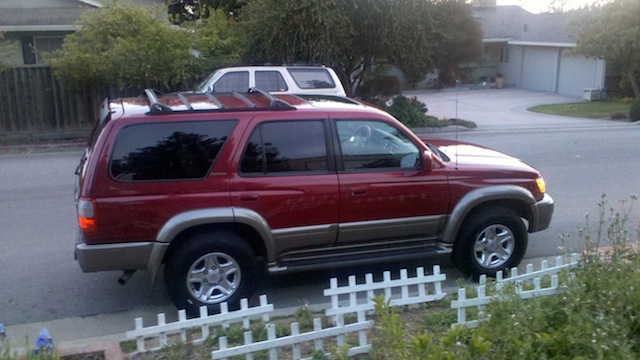

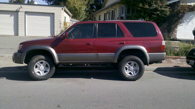

I finally got my lift on yesterday after waiting months for all the parts and time. I ended up doing Tundra TRD Y/Y Y/B coils with KYB shocks (from previous owner of the Tundra coils) and a 3/8 Toytec spacer. In the back I used Downey 3" coils and OME N86 shocks.
Well in my awesome stupidness I put the Tundra coils on the wrong side. :redbrick: I was rushing and looking up the positioning on my phone. I must have misread the small text and put the driver side coil on the passenger side.
I just realized it this morning after checking it again. I'm so pissed right now and feel like an idiot.
My question is there any major negatives of having the coils on the wrong side? I know one side will be taller than the other, but can I still get an alignment for the time being and change it later? I won't have the time or tools to switch them for at least 2 weeks and I may just take it to a shop.
Measurements:
Before the measurement were taken on uneven grass so not the best.
RR: 11 3/4
RF: 11 3/4
LR: 11.5
LF: 12
After:
RR: 14 7/8
RF: 13 1/8
LR: 14 7/8
LF: 13 1/4
I will remeasure tomorrow morning as my daughter was in my arms at the time, so not the greatest measurements.
Will switching the coils to the right side make a difference in the front measurements because I only got ~ 1.5". It might have lifted more, but I didn't take measurements at home before I lifted it.
I also have a set of used 265/75/16 Cooper Discoverer STT sitting in the back of the 4runner waiting to be put on. I should have that done Tuesday or Wednesday. I'm happy with the lift in the rear and it will settle a little, but the front needs to be higher. If I don't get anymore lift out of, then 5100's will be bought this Christmas.
Here is a picture for now, I didn't get any great before shots as well. Pretty much dropped the ball on this one. :nono: I will get more tomorrow.
Before and after.

Thanks for all of the replies. Yeah I'm going to remeasure today, but it seemed like it was level enough. I just wanted to make sure I won't be messing anything up by having them on the wrong side. I'm fine driving with them on the wrong side for now and eventually changing them as long as I can align it properly. Plus the alignment place I will be going to has a warranty for a year after, so I could always just go back after changing it. I will post new measurements shortly.
The left/right specific springs are only there to provide a level ride height, if the ride height is level anyways, then you won't hurt anything by running them "backwards".
Sweet, thats all I wanted to know. I will just run them how they are for now and check my heights in the mean time. After that if they are really different I will switch them.
