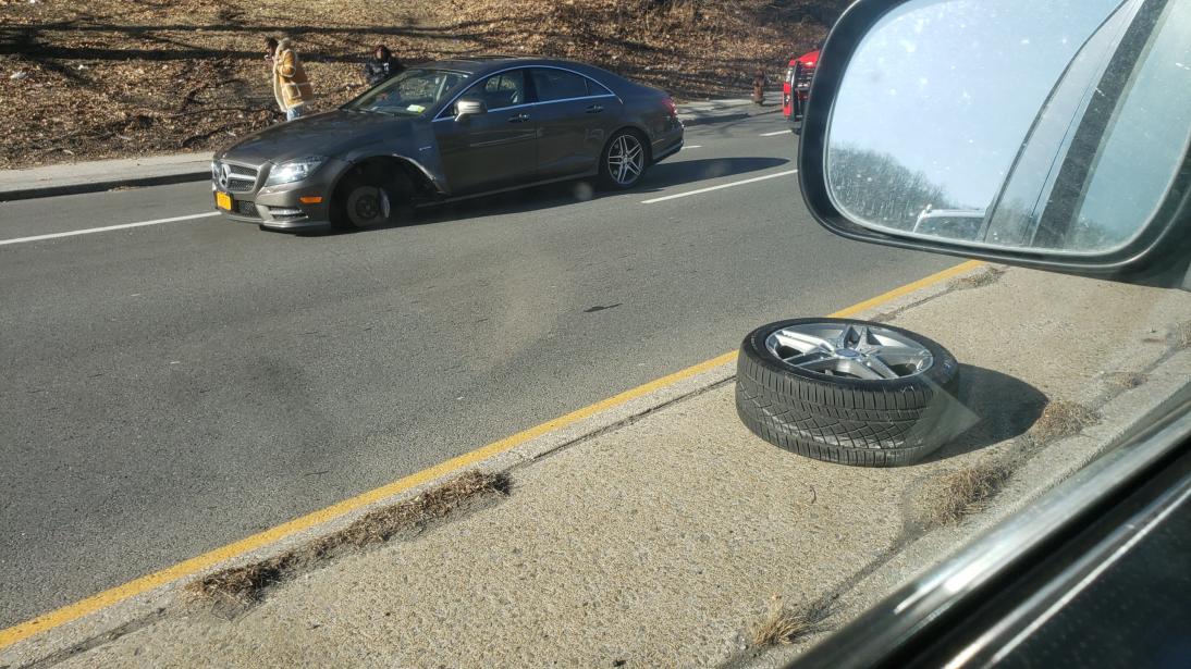

Thought of this thread while I was sitting in traffic coming home last Friday �� at least it wasn't a Toyota
Imgur: The magic of the Internet
8fU7dcL
Imgur inline link doesn't work from the advanced image adding tab? Huh
