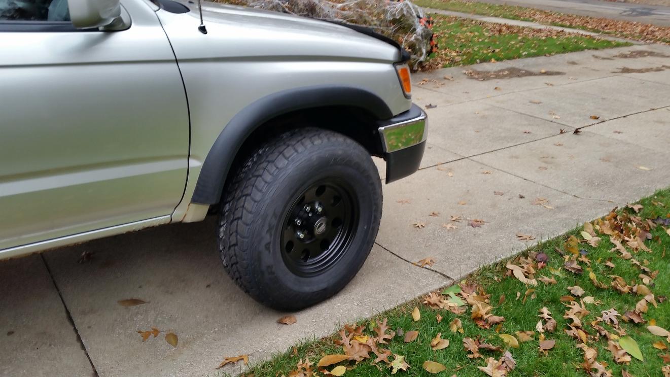

No, no modifications to the wheel. I should have pictures tomorrow to make this an interesting thread lol. I bought a set of Crager soft 8's and new of tires, I should get the truck back tomorrow after work so I'll upload either tomorrow or Saturday morning. I assume the po must have done something, all I've used it for is daily driver duty and some camping with LIGHT dirt/logging trails.

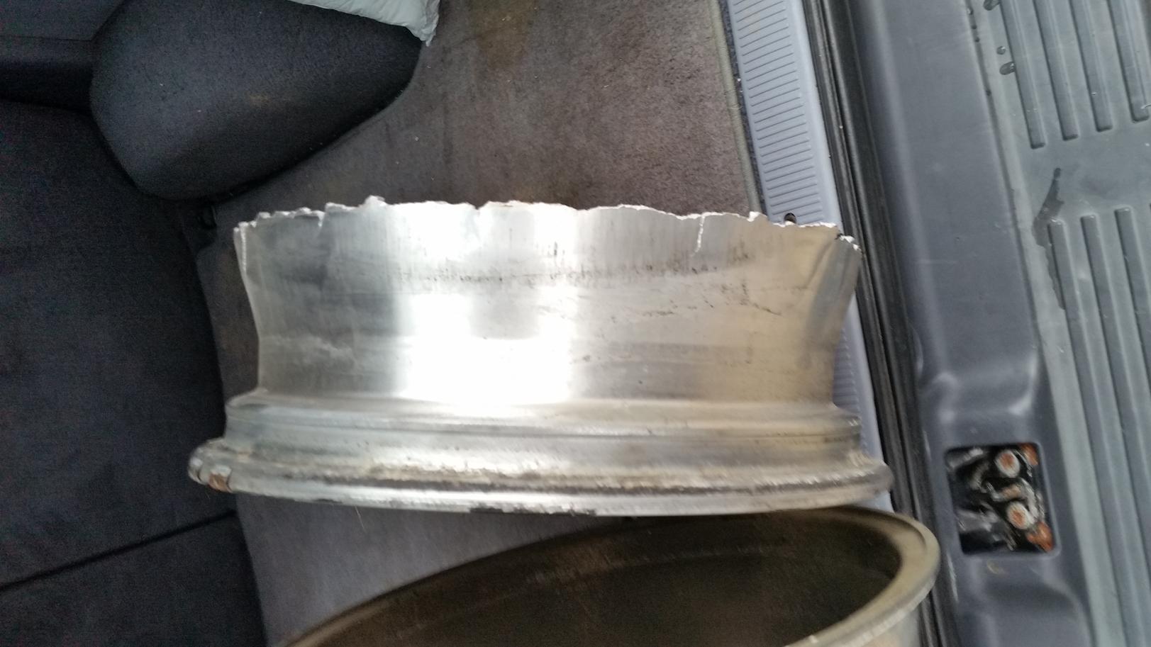

So, as promised a split wheel!

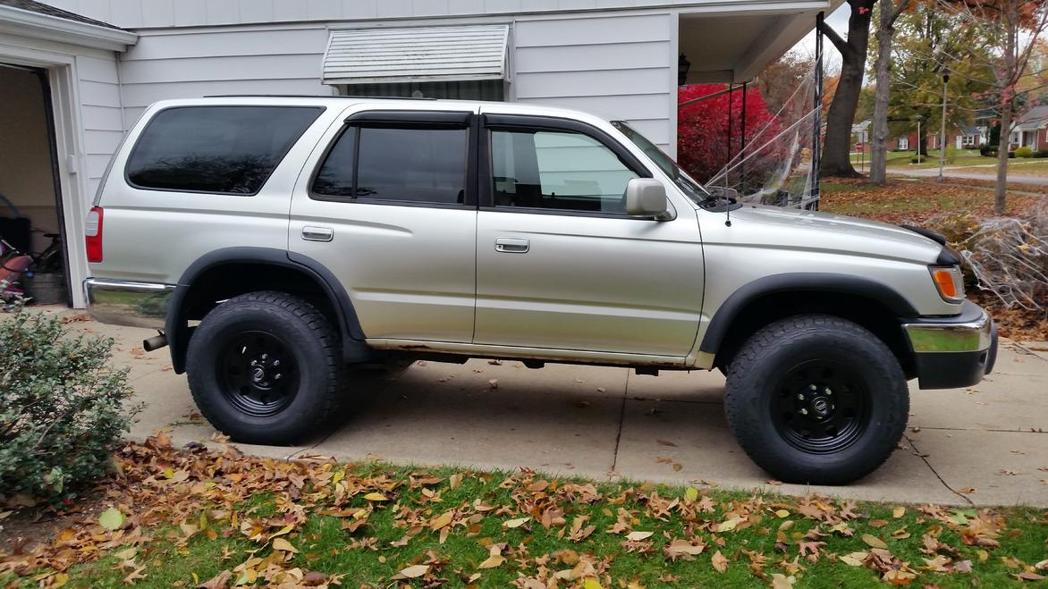

This is how I'm sitting now, I'm thrilled with the new rims!uploadfromtaptalk1446249057075.jpg

Defective manufacturing process from the factory?
I wouldn't think so, the truck has 110k miles. I, like past posters, assume there was a pretty solid hit at some point that caused a stress crack. Then with temp changes or just daily stress caused it to split.
I read this before the picture, but didn't really realize what you meant when you said split until I saw the picture. That's pretty scary...
Damn....I've seen this with Chinese aftermarket wheels, but never with a factory wheel!
Was that a "split 3 spoke" wheel?
