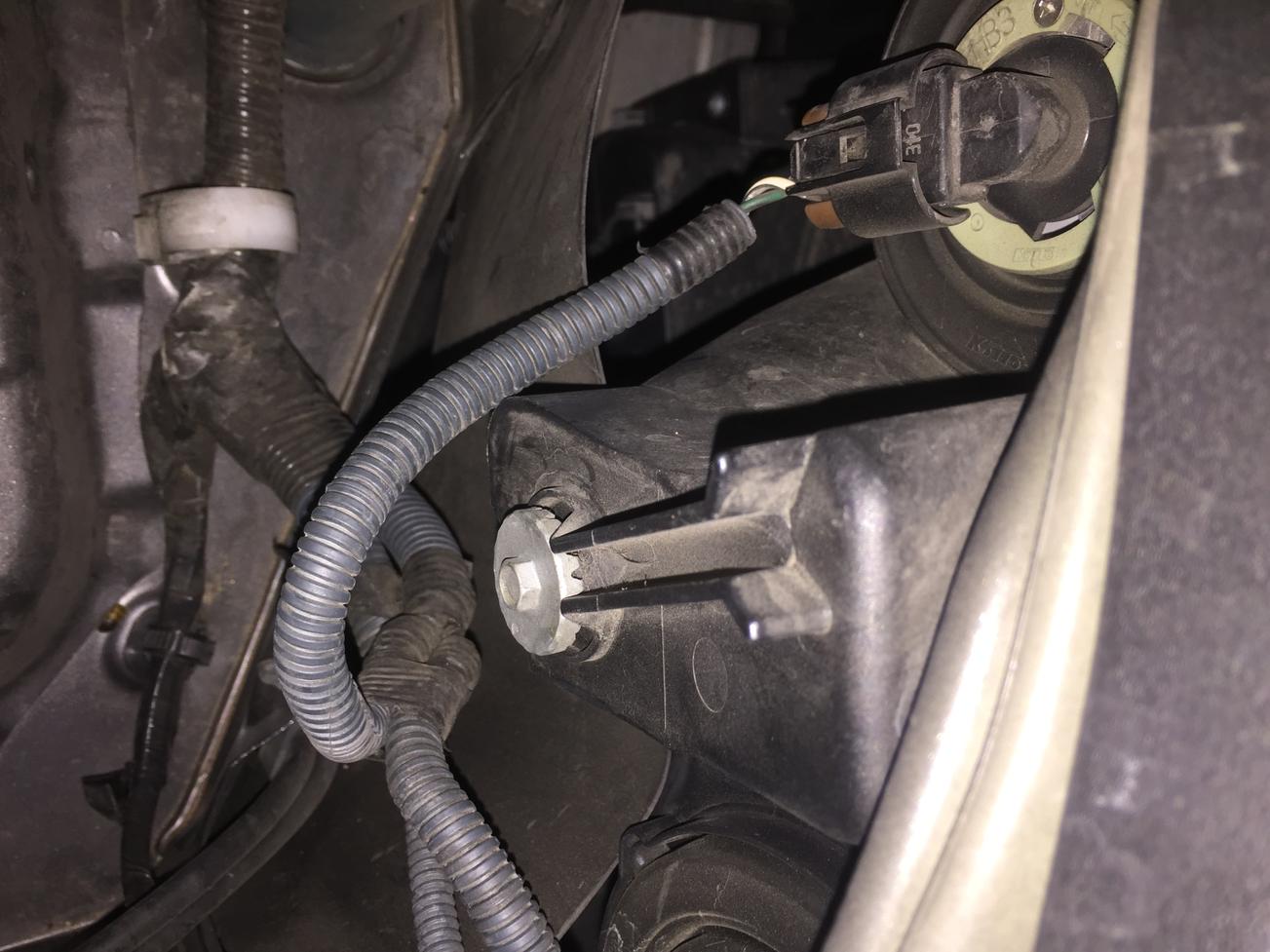

you cant aim halogen bulb housings, son.
shit your right sergio. The bolt in the picture must be the drain and fill bolt for the headlight fluid. Not to be mistaken with blinker fluid, that would cause your headlights to strobe.
:behindsofa:
:wtf:
I think you don't know what you are talking about. There is a difference between 2010-2013 4Runner's halogen housings and 2014+ 4Runner's with projectors. I don't think halogen bulbs or housing can be aimed. I could be wrong, I dont know everything. Maybe someone else will chime in.
unless you have self leveling headlights, you probably have some form of adjustment. There is no way every headlight leaves the assembly line with that precision. There's always error and there's always an adjustment for it. Hell, i bet even self leveling headlights have a manual function in case things fail with the system.
Projectors are halogen. I think you're referring to reflector headlights. Projectors and Reflectors both use halogen bulbs.
