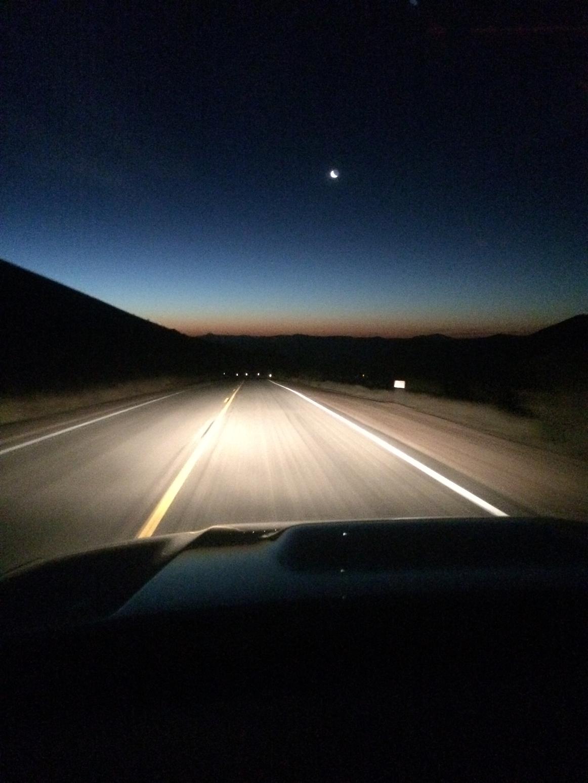

runer4life-albums-my+pix-z-picture37477-i-also-installed-h11-xtreme-hid-5000k-digital-conversion-kit-its-best-upgrade-imo-no-i-do-not-get-high-beams-thrown-me-oncoming-traffic.jpg
I also installed an H11 Xtreme HID 5000K Digital Conversion Kit. It's the best upgrade IMO and no, I do not get the high beams thrown at me from oncoming traffic.
