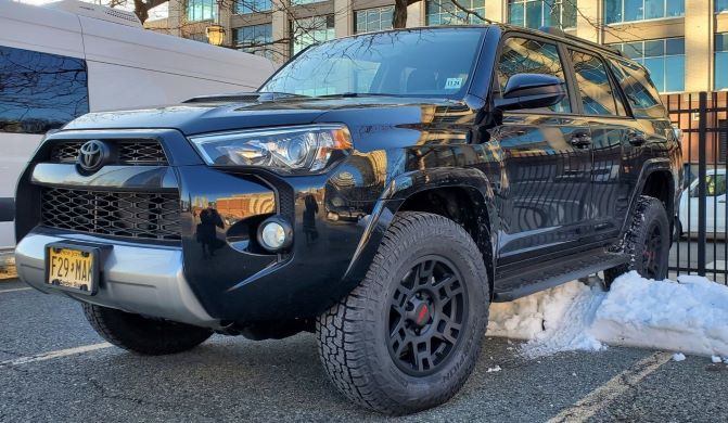

On my ORP I run PIRELLI SCORPION ALL TERRAIN PLUS they are a pretty good and low noise on the highway, handle bumps well.

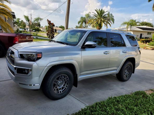

On my Limited I have BFGOODRICH ADVANTAGE T/A SPORT LT, these are a great tire for on-road use. My Limited rides very nice on the highway - smooth and straight tracking with these tires. - 5 star rating on Tirerack.
My sliver Limited with BFGOODRICH ADVANTAGE T/A SPORT LT's
My black OR with PIRELLI SCORPION ALL TERRAIN PLUS

The Scorpions are quite good in all areas. Even on the Jeep, I run MTRs which are the quietest high-performing MTs I know of. Some are obnoxiously loud...like I can't stand being in vehicles with them on. I got rid on some new Nittos in 3 days once. Dick Cepek and all those MTs are just freaking annoying. KO2s are decent for aggressive ATs.
