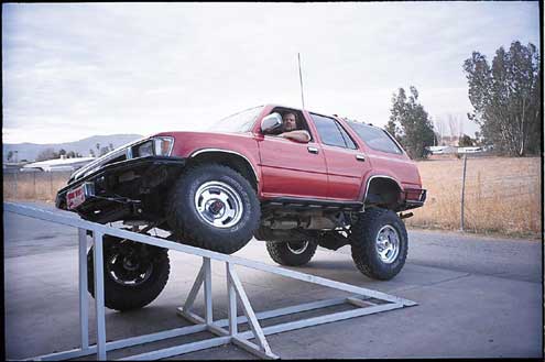

Alright, I know this is a broad question, but I really want to do this work to my 4 runner as the improvement of my 4x4ing adventures would be much better by swapping out the IFS to a solid front axle.
First of all, I get the basic idea of taking out the IFS system out of the front and putting in the solid axle.
What do you have to remove? Im unsure of what to really do, as well as what is a recommended axle to swap it over to.
I have auto locking hubs, do I have to change it to manual locking hubs if I swap it over?
What is the usual cost if I were going to do this work myself? And are the benefits really as good as it looks?
If anyone can give me some solid advice to stand behind while looking into to doing this job it would be appreciated!
Cheers guys
Steve
