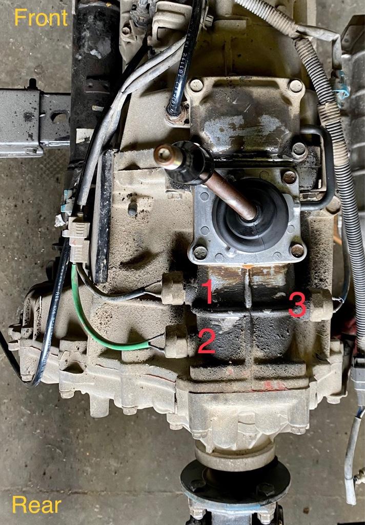

[MENTION=643492]JustTroItIn[/MENTION] so a faulty ADD Position Sensor would explain why I was seeing the indicator light, and the click sound I was hearing was not the actuator but rather a relay, I guess?
So, if I do decide to replace the faulty ADD Position Switch, I think I’d need Toyota PN 8422235110
Can anyone confirm the part number and also which switch it is on the photo below? (I'm assuming the ADD Position Switch in on the transfer case, correct me if I'm wrong. If the body was still off the frame, I'd be able to just following the wires...)
