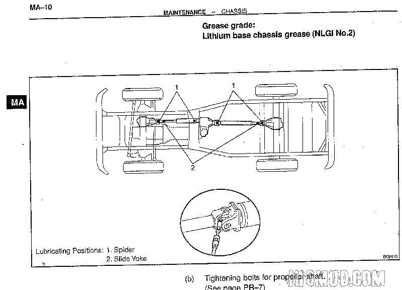

The Landcruiser does not have any zerks for lubrication? Just curious.
Guys, search on the moly vs lithium, vs standard grease. The FSM for the 4runner says one thing, then there's a TSB changing when the FSM says. I don't have the links handy, but I think the double cardan take moly based, and the rest take standard grease.
