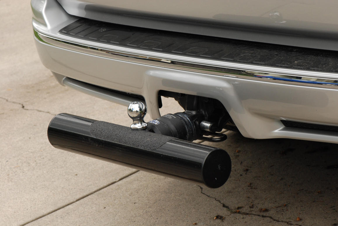

Have to agree nothing like the "super bumper" Put one on after my Subaru had a slow speed impact and cost me 1500 to fix. (parking lot hit and run). Put a "super bumper" on the 4rnr, and use it to pull my watercraft. Also makes a good step up for roof cargo.

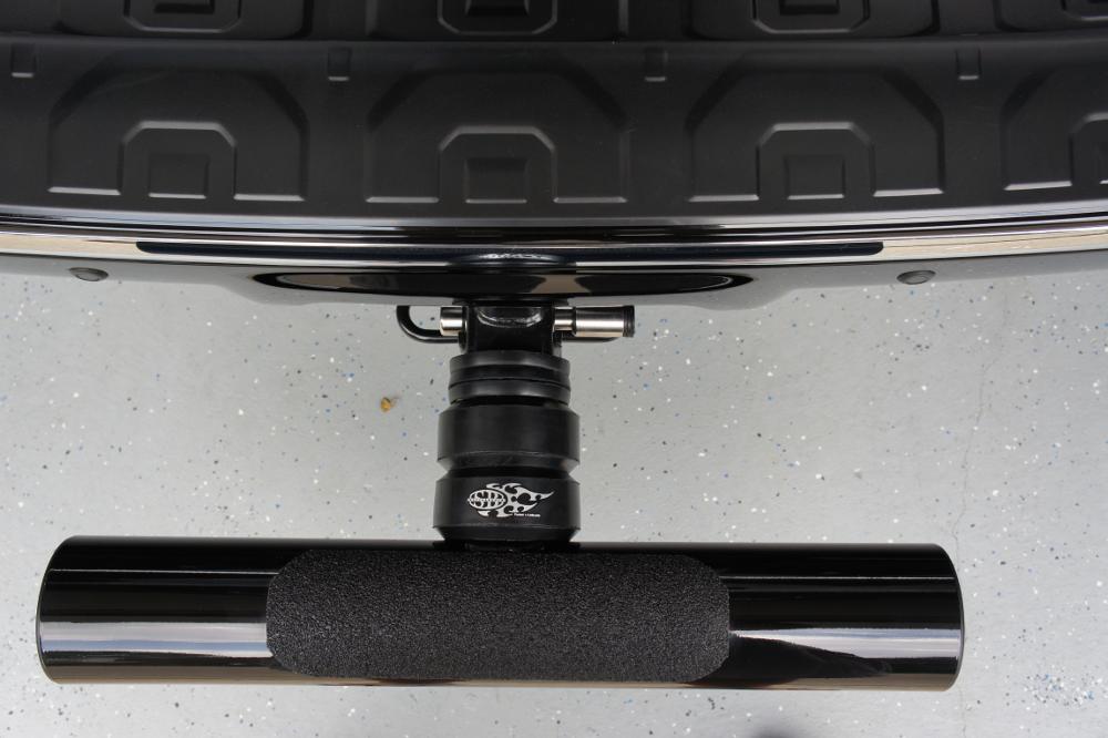

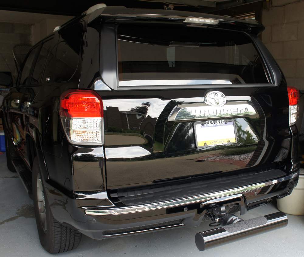

Got a SPAREBUMPER Model SP424 - Black last week. What a great solid product!
One caveat doing installation. Distance from the outside edge of my receiver hitch to the center of pin hole is 1 ¼’’which is less than 1 ½’’ required by spare bumper(1/4’’ short). I had to call Jeff @ Mohr Manufacturing to get an extra rubber spacer. Jeff provided it free of charge. Meantime, I’ve cut some temporarily rubber spacers from some rubber laying around to make a decent compression and avoid any bumper rattle.

Could you guys comment on what effect your product has on the back-up alarm? I sure wouldn't want to disable mine?
Unfortunately backup sensors do not work with the sparebumper SP424 model - it has an interference with 2 center sensors. I did not find any suitable solution yet, so had to turn backup sensors off just for time being.
On a long term, I would like to do one of the following:
- Disable/disconnect 2 center sensors.
- Relocate sensors to the sparebumper.
