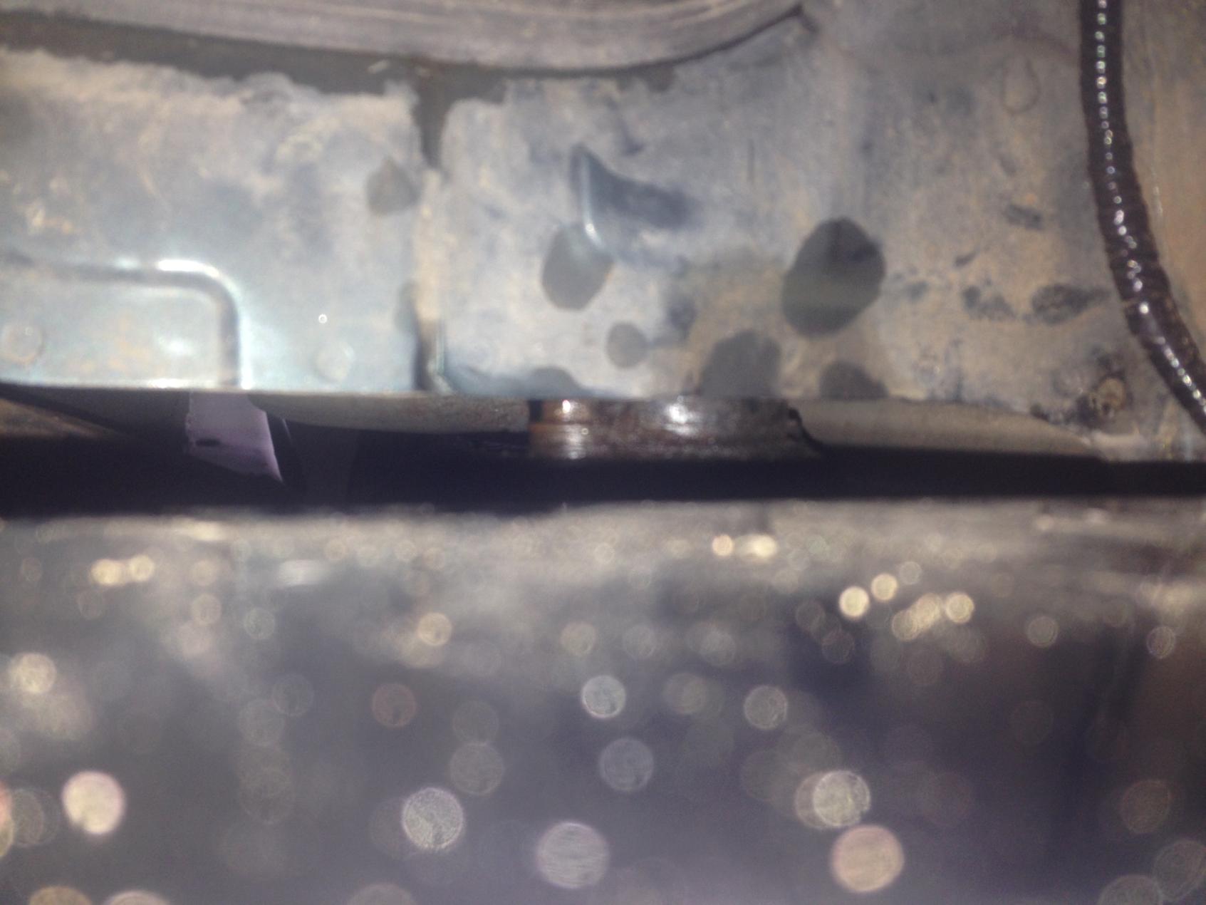

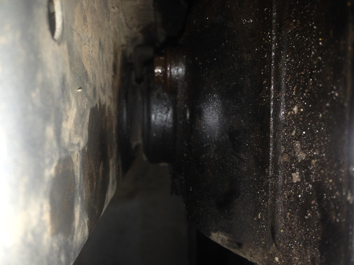

Well, I'm back again and the damned things won't budge. I think I've successfully stripped one of the bolts with my 12 point box end wrench. I can't imagine that Toyota ever planned on folks having to change these but here I am. It's such a small space that I'm guessing that they bolted these before the body was attached in the initial assembly. There is no way you could get a socket on these unless you cut a hole in the interior of the body. I'm about ready to give up but I'll post pictures in case anyone has a secret method to getting these off. IMG_3666.jpgIMG_3665.jpg

Drill them out from the bottom and get new bolts. A 'normal' drill bit from the bottom may even just screw it out for you after it has put enough heat into the bolt.

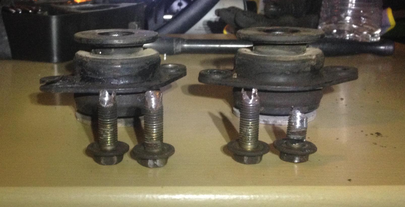

This is what I ended up doing. I drilled out the bolts/nuts from the bottom then replaced them by putting the new bolt in from the bottom. I couldn't get my jack high enough to slide the mounts out cleanly so I stuck a 2x4 between the body and frame and levered the body up while sliding the old mounts out of the way. Not the safest thing in the world but I still have all my fingers. The Sonoran steel mounts disassemble so those just slipped right in. I haven't heard body clunk since. I really appreciate everyone's help. I'm glad it's over.IMG_3668.jpg
