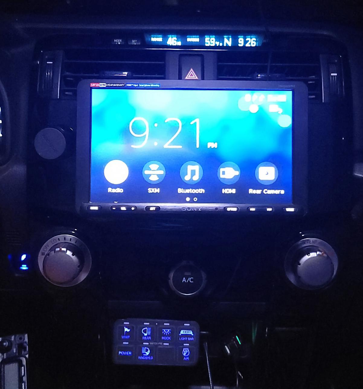

Hey I just did this install last month, it was pretty straight fwd. I did have some hang ups with my anytime front/ rear backup camera but Cliff was on point when it came to support. He took the time to video call and walked me through the fix. I definitely support Trail Grid Pro, just from customer service alone they are great!

It covers half the AC/Heater vents.

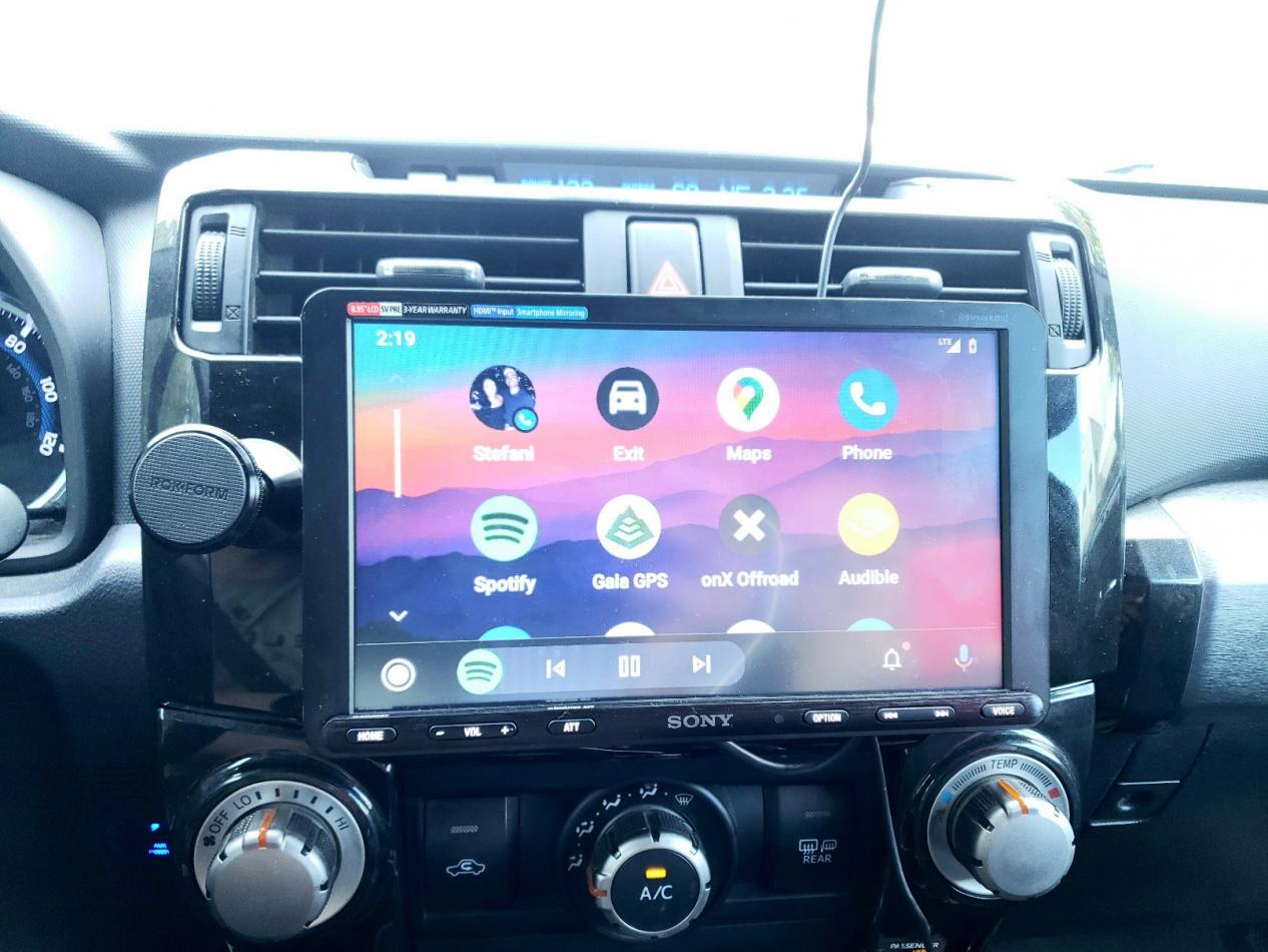

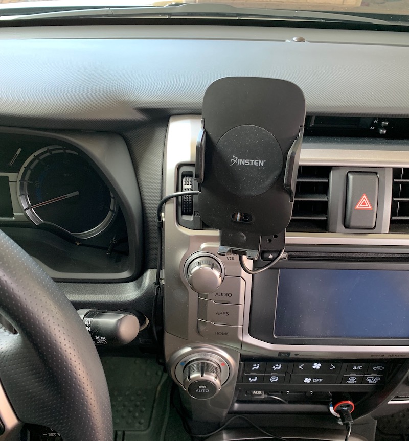

Looks great!. I'll have to move my phone mount, but with Apple CarPlay on that nice new touch display, I will no longer need the phone screen to be quite so accessible.
I understand the concern about air flow, but this phone mount covered a fair amount, and I never noticed a big difference. And I live in Texas, so there's that.

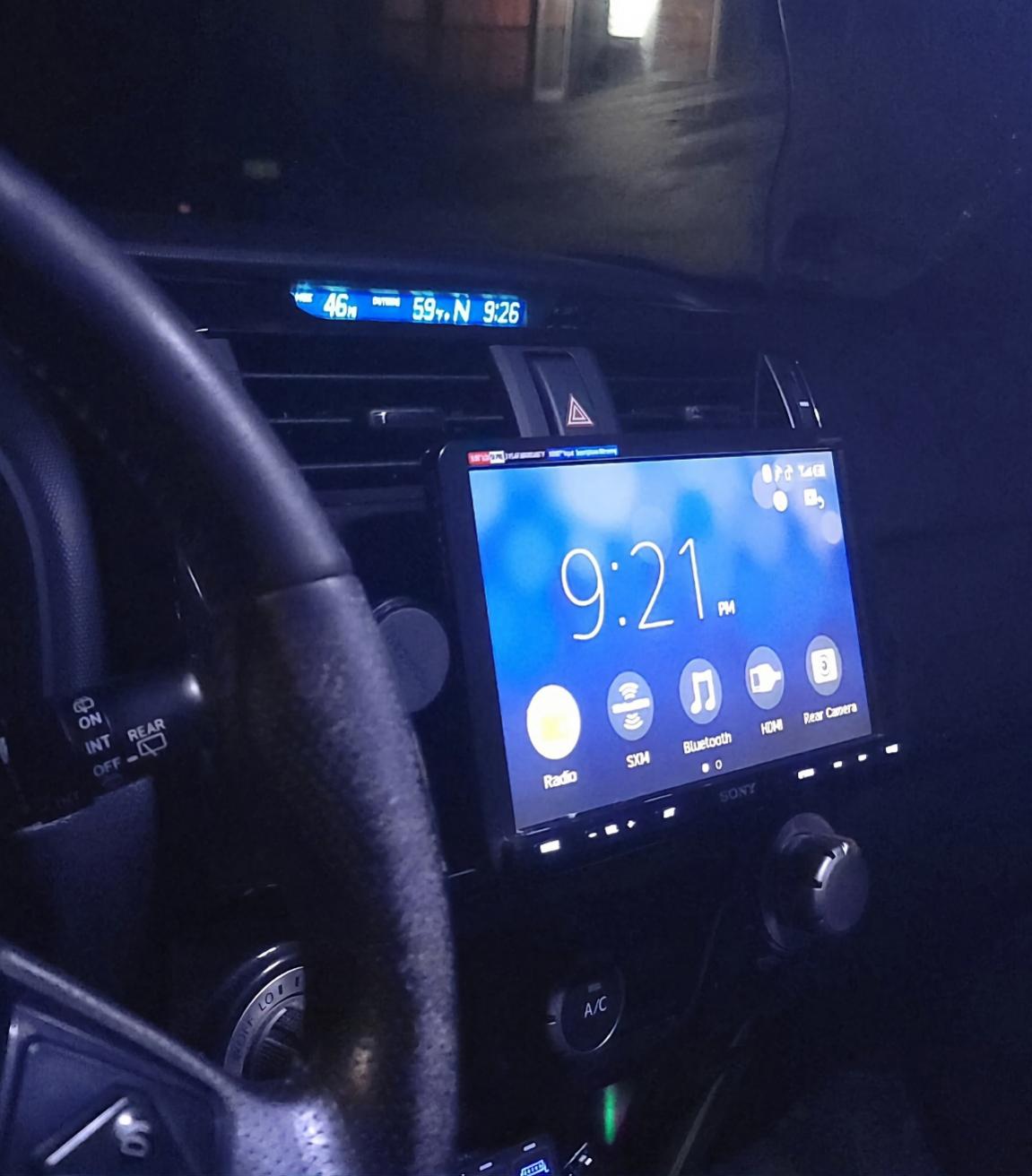

On the vents, it does cover some of the areas. I took some better photos front and side. Not sure how worth it would be or if it would make much difference, but I have to imagine someone could 3D print some contraption that blocks the air from flowing through those portions. It doesn't bother me, nor does it seem to get to hot behind the unit if the heat is going.
