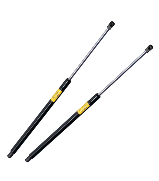

If you are installing sound insulator in tailgate, order stronger door struts. I've used few generic options with bad fit an too much power. Best one I found is sold by Gobi: GOBI Rear Gas Springs - Toyota 4Runner 5th Gen with just right amount of power and good fit.

Run power accessories as other mentioned, change any gaskets that are passthroughs to the bottom of the vehicle from a plug to a marine grade passthrough for future access if needed. Doors and hatch will increase weight of those components, so struts on the back hatch will likely be necessary. I wouldnt worry too much about the floor as its very rigid, but the quarter panels and doors are very thin and the sound deadening will help tremendously.
