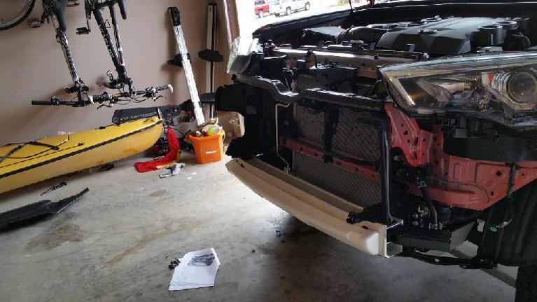

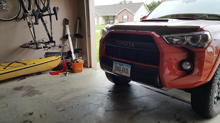

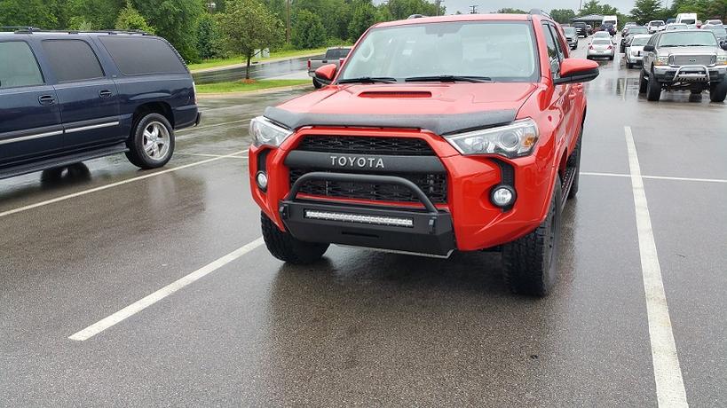

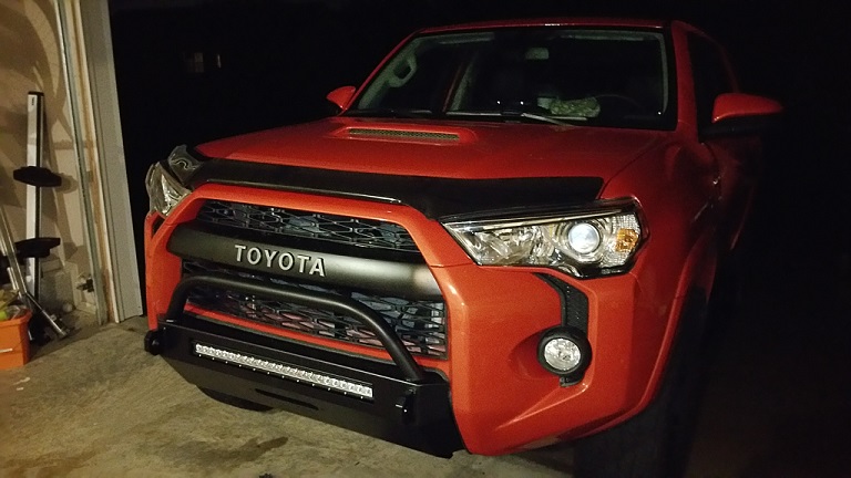

Started working on putting the bumber on after work at 530, finished right about 10PM with a break for dinner. Did it by myself as I didn't have anyone available to help me out. Wasn't too bad, besides the m12 bolts being a PITA and not wanting to thread at first. All in all a pretty painless bumbper install!

Looks Great!!! Excellent job.
Thanks! My heart was racing when I whipped out the dremel to start cutting on the bumber. My poor girl! :)
Also, a heads up for anyone that hasn't installed theirs yet! Wear eye protection when you are cutting up your bumber. I got some hot ass plastic in the eye. Learned my lesson and grabbed my eye pro!
