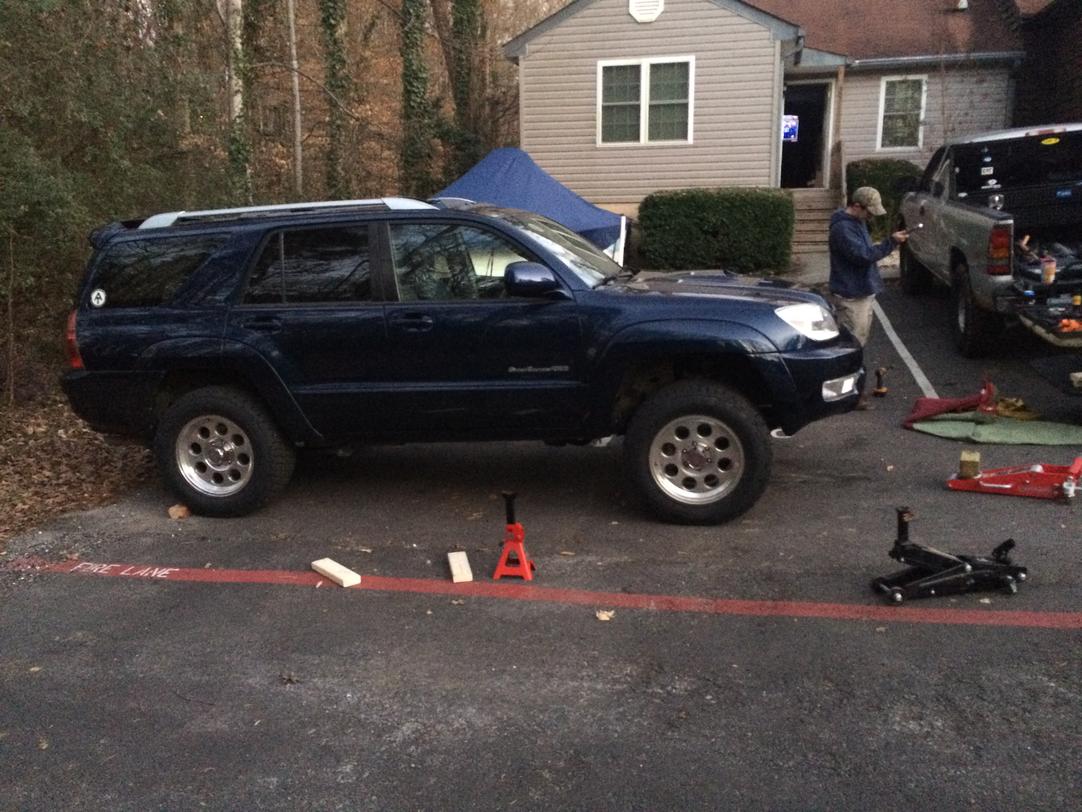

I like the squatty look... Don't know why but you see it a lot in the Carolinas and I have always liked it so no plans for the rear suspension. But did anybody else notice the XREAS lines at sort of an awkward angle into the shock after installing their spacers upfront? And I have driven about 40 miles since the install, will definitely go back and re-torque everything soon.
Here is a pic of the finished product

Dude....that is way too high in front. It makes the rear look like it's sagging. I think you're taking the pre-runner look to the extreme.
Dude....that is way too high in front. It makes the rear look like it's sagging. I think you're taking the pre-running look to the extreme.
Does look kind of weird, but To each their own I guess.
We don't discriminate, because we're family.. Shoutout to all of the kid-friendly moms and dads out there (OHANA) lol .. :party:
Hahah just the carolina squat man no pre-runner for me. It does look like the trunk is full of bricks but thats the way I like it. I don't wheel it much either so just for looks
