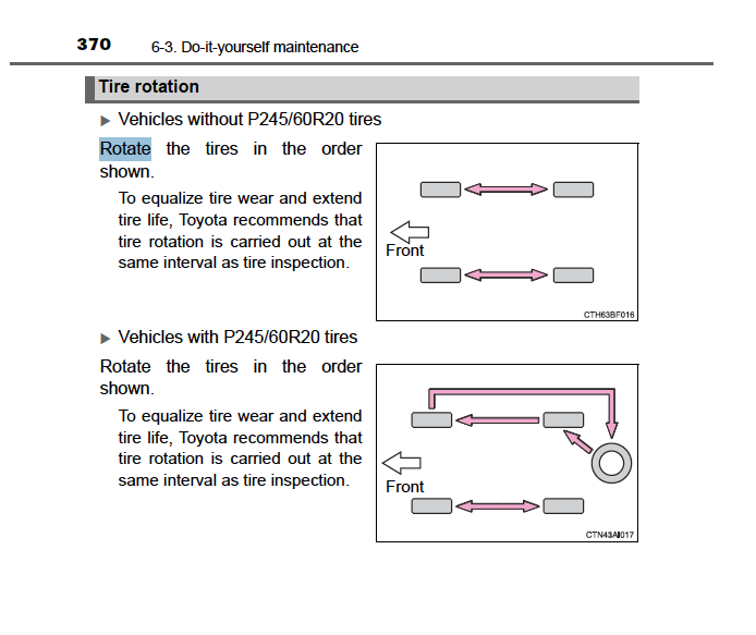

back to the OP... here's an interesting image I found regarding 5-tire rotations (see attachment)
Yeah the manual has a rotational diagram including the spare but it's only for 20" wheels. I'm assuming the Limited has a matching spare rim???
