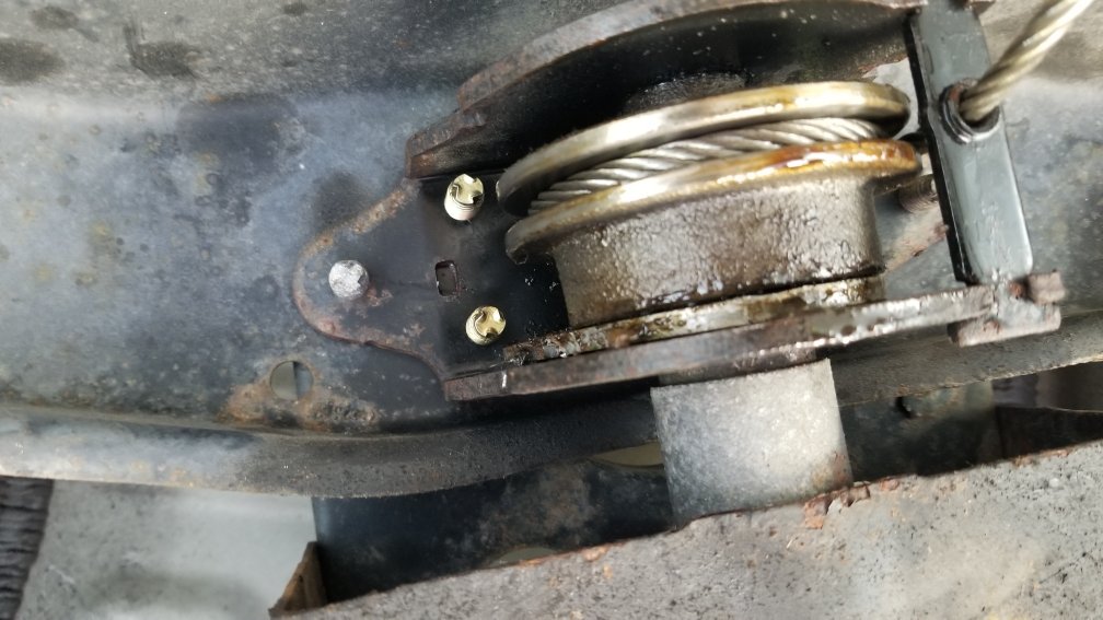

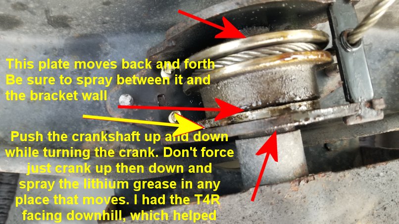

Mine got stuck halfway down, wouldn't go up. I recall using most of a can of Liquid Wrench on it and rocking the crank back and forth. Eventually it broke free and I got it all the way down. I lubed the mechanism with more lithium. I kept raising and lowering until it was working properly. My cable was in good shape so no need to replace it.

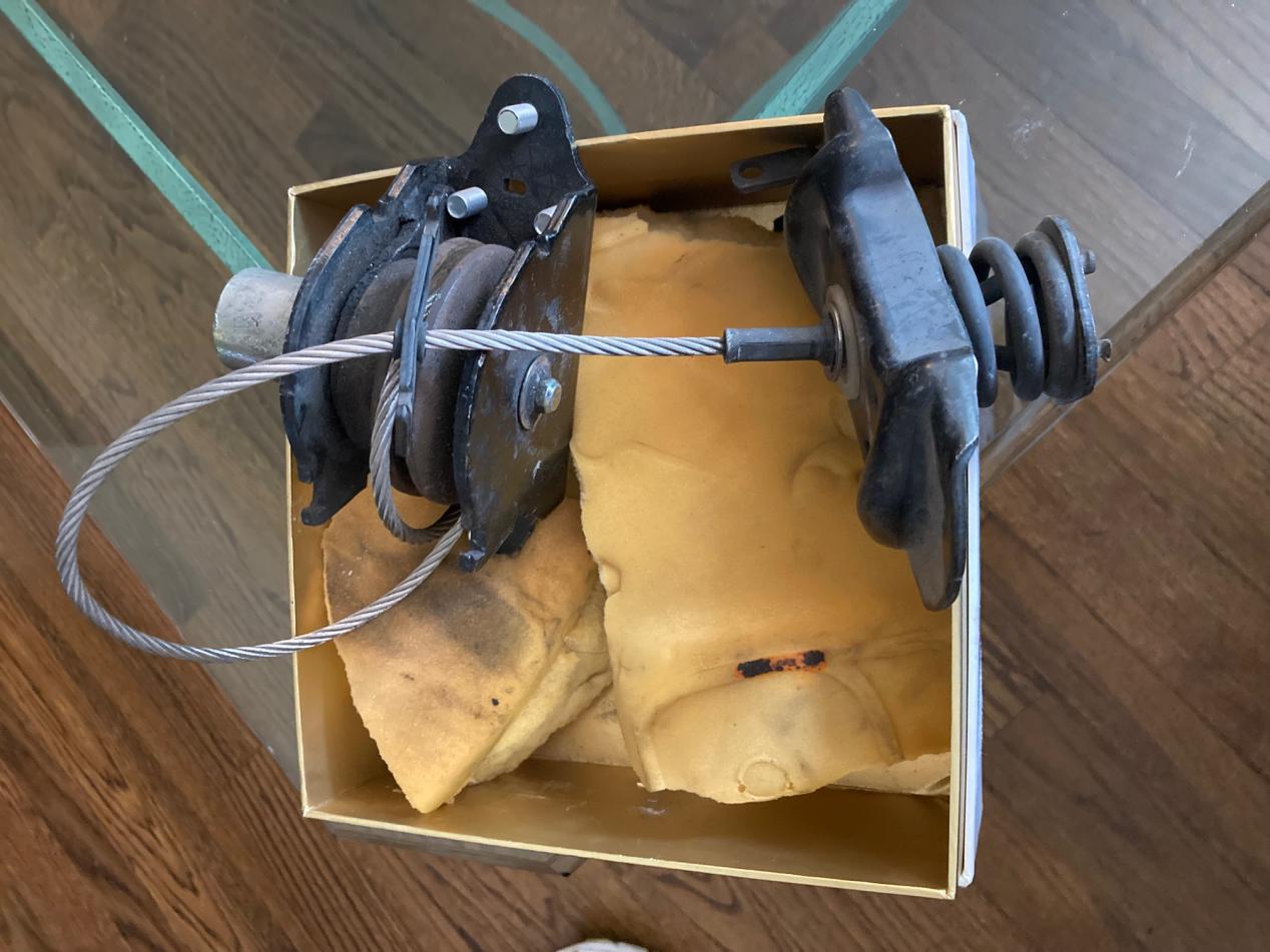

I can confirm that 51900-60280 is the correct part number for the spare tire carrier for the 4th gen. It is just what you see in the pics, no other covers or shields are included, not even the 6 bolts (?). My 4Runner is a 2004.
Like daprotege5 wrote, the new carriers have a chain instead of a cable. There are new ones with the chain on eBay for a lot less than the Toyota Parts Overstock place in your link.
If you’re interested, I have a used one with the cable (and the six bolts!) that I bought on eBay from rust-free SoCal that I don’t think I’ll ever use. (My 33” spare is on my roof, and I still haven’t removed my old rusty carrier yet (Chicago area rust). $100 shipped? (Shipping would cost me ~$20). If you’re not interested, no problem. $100 looks like the going rate for these on eBay, even the used ones. The new ones with the chain are only about $20 more.

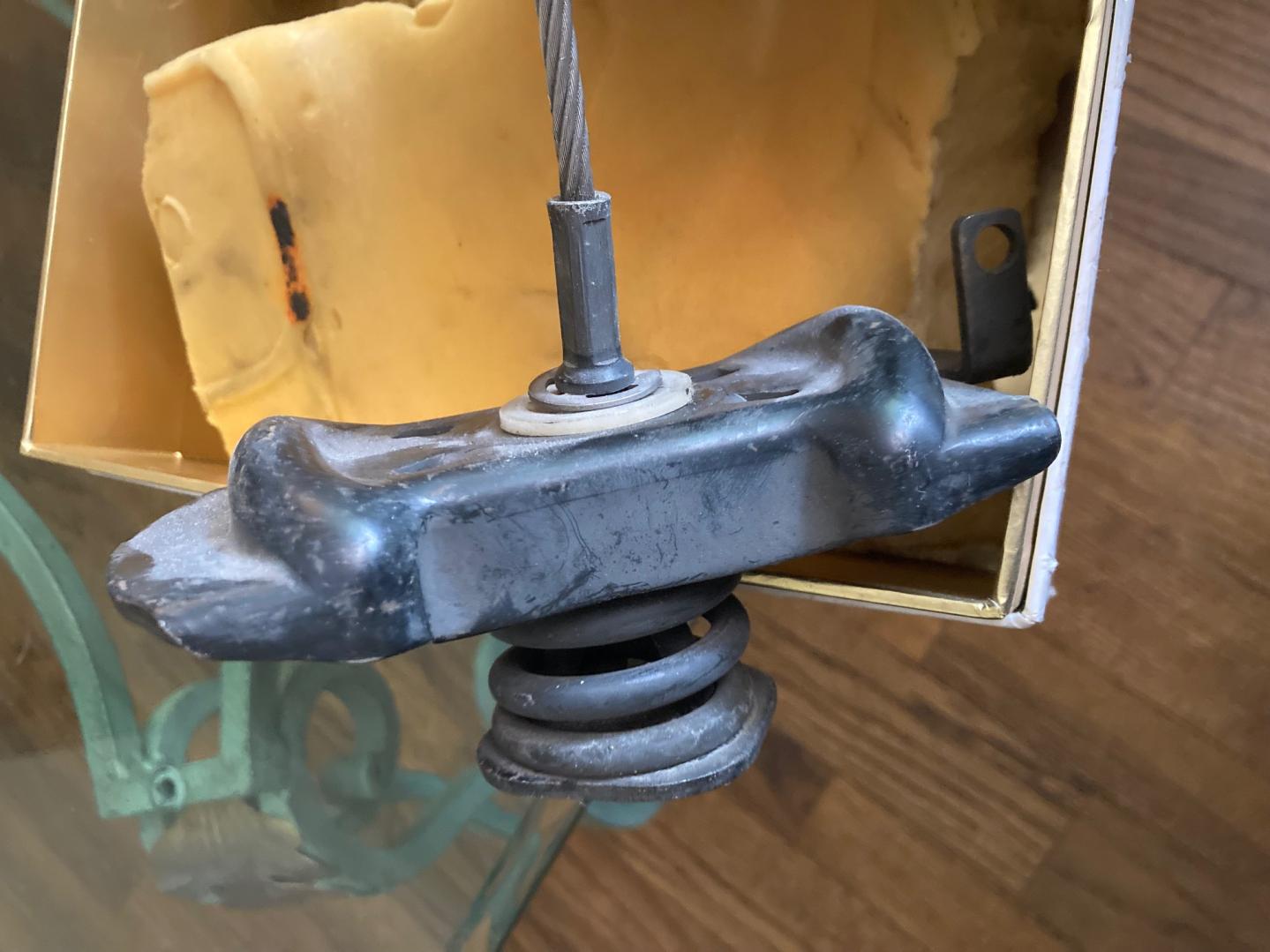

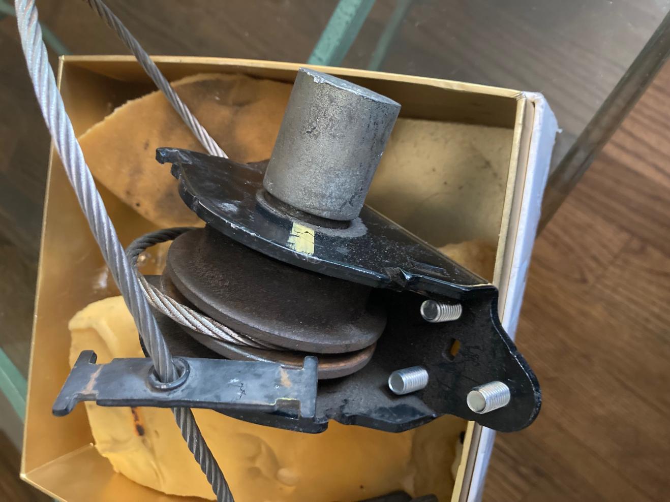

I couldn’t figure out how to attach files to a PM, so here are 3 pics of my used spare tire carrier:
