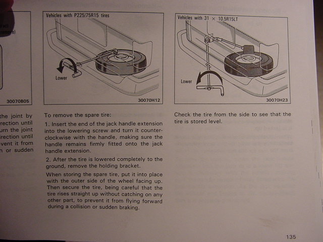

Do you have the manual that came with the truck?, it shows you how. you stick a rod that comes with your kit at a angle in the hole and turn it to drop it down.
If you don't have the manual I will take some pic's for you and post let me know.

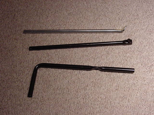

Here is the tool you need. yours is not in the passenger side storage bin in the back in a black bag?

See the pic above of the owners manual that is what it looks like if I took a pic it would be of a tire under the truck/But I will take a pic if you really want me too.
So there is nothing underneath the tire holding it up. Is the stuff holding it up all above the tire. Couldn't tell from the diagram.

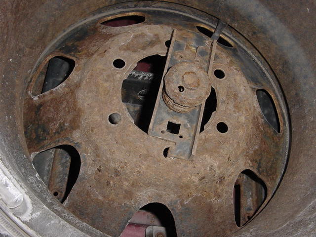

Ok I went out in the cold and took a pic for you.(things you do for your fellowT4R.ORG guys):)
Sorry it is so muddy and dirty had a little fun not to loong ago:)
you can see there is a clamp holding the tire on and it is held on with a thick wire and you put the bar in the bumper and spin it to lower it.
Hope this helps.

Just on a note on my 90 4runner the jack and tire lowering tool is stored under the back seat not in the tool bag you might be looking in the wrong place the tire lowering tool is about 30 inches long it has a hook on one end and a square shaft at the otherthe hook end is what gors into the bumber also if you look at night using a flashlignt open the tail gate and then look between the tilgate and bumper you will be able to see where the tool fits to lower the tire
Hope this helps
