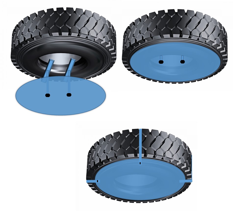

Anyone seen one? I know dragging it is rare, but those occasional big drops to flat.... I'm rigging up a hybrid rear bumper, so was thinking the spare will be the last thing holding me back (no swing out at this point, maybe down the road).
I've got simple design in mind. Basically a 33" disk with some long carriage bolts, a bracket and some wing nuts. (It will have to be installed after the chain is hooked up) The other option is some ratcheting straps with some hooks
Who thinks the first design will hold the skid in place by friction with the tire. I'll probably do 1/4 aluminum and possibly glue tire tubes to it for the rubber to rubber areas. I think that will keep it in place. Am I crazy?

I wouldn't call you crazy - But it seems as if it would mostly be a mud collector.

Option A seems much better then ratchet straps and hooks to deal with. As mentioned I would make sure there are at least some holes in the center of the plate to not turn it into a mud/water collector. Its not a horrible idea, I would think the best is to remove it from under the truck but as you mentioned a rear swing out was not in the future and putting it on the roof is its downsides.

I think an 1/8" steel plate would work fine since no matter what you build, the weight or pressure is carried by the large surface area of the tire anyway. Maybe the front edge needs to be rolled up, maybe not. The front edge of the tire may be protected by the differential and axle anyway. The bumper is farther back than the spare tire. If the tire is going to rub your bumper is going to scrape off anyway. The tow hitch tube may be the lowest point of contact in the rear.

Yep, axle covers most of the front edge of the tire. A 285 spare hangs down a bit as you can see in the pic. The hitch and exhaust take the brunt of the abuse.
Not crazy but it seems over complicated and you'll lose clearance. The lowest part of the tire plus an additional 1/2" for plate and washer. And an edge to catch.

The spare protects the exhaust.... and offers a nice transition to slide off the back. There will be no edge to catch. The leading edge is protected by the tires themselves (in general).

Have you considered going with tubing? pair of parallel tubes that run under the spare and curve up to a the rear hitch could offer good protection. You could use the hitch as one mounting point for strength. And it could be pretty cheap/easy to fab. I would make the long bolts run up and just bolt them through the lug holes in the spare tire.
This option wouldn't be such a mud/dirt trap.
I did not think much about it being a mud/dirt trap.
I don't find much dirt in the underside of the rim now and there are not huge holes for it to get out. It seems like the plate would mainly keep it from getting in from the bottom. It is pressed up pretty tight on the top (although some can still get it). Water drains would be needed but that is about it. Good idea on the lug holes. That would eliminate the need for a bracket.

I like the idea a lot and in fact have been toying with this exact idea in my head for the past couple of years. I was thinking the same thinng: a lightweight piece of flat metal (maybe even aluminum) bolted up to the spare tire wheel. For my wheeling (and [MENTION=106176]wfo9[/MENTION]) here in Central Texas and when I go to Moab, mud is not a problem. What is a problem is dropping down off large ledges onto the spare as [MENTION=78273]Jeremy556[/MENTION] and [MENTION=106176]wfo9[/MENTION] said. I'm also in the same boat that I don't want a swingout. I like the clean loks of the stock bumper and light weight. Plus I don't want to drop $2k on a bumper.
