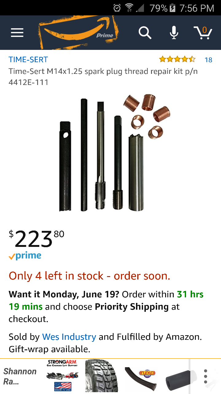

This is the kit I bought. Had very complete instructions as well.

200 is to much for something you're going to use maybe twice.
go to O'Reilly's and fix it for less than 30. :noidea:

**** me dude, $200? Jesus christ... Worth it I suppose
It comes in a nice case that I can keep with the rig 100% of the time for many years to come. It's proven and cheaper then many alternatives. If I'm out in the middle of nowhere, $200 is nothing compaired to walking 50 miles.
