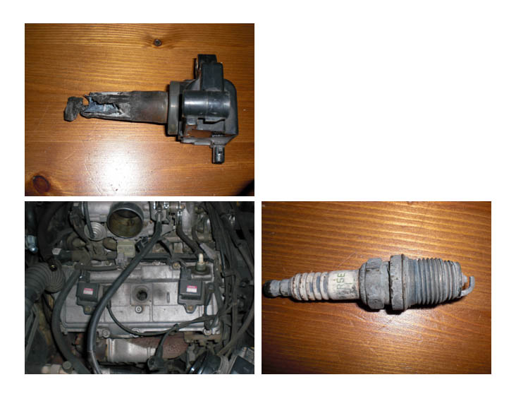

This is the second time my 96, toyota 4runner3.4l, blew out the sparkplug, threads and all. Not only that put this time it blew out the Heli coil I installed last time and melted the second coil.
Does anybody know why this happens or seen this before.
I posted some good pics.
Please help if you can.

I'm guessing that someone cross threaded the plug hole before you got the vehicle which led to the first failure. Did you pull the head to do the Helicoil install? If it was mine I would get another head and do it right. I know it's a big job and not cheap but the band aid approach doesn't seem to be working. It's a high stress point and it would be hard to keep the Helicoil sealed and locked in place. The melted coil points to hot gas leakage past the threads.

I can see where a compression check could look normal, but once you start the engine you literally have explosions going on right under the spark plug. Also if the head is aluminum and the insert is steel then they are going to expand and contract at different rates during heating and cooling which could eventually crack the sealer allowing leakage.
Yeah if the Time sert is failing, you are pulling the head for sure. I don't know whats really available to you in Germany, but it might be worth making a few calls to see if there is a machine shop that could actually repair the cylinder head. Otherwise car-parts.com shows them from $400-around $100 for a single head. Shipping is gonna cost though. I would check yota techs classifieds as well for some heads.
Unfortunately, I have seen this case before. I repaired one where the #6 Spark plug had blown out and had destroyed the threads and had melted the coil pack on the way out. Your only option is to remove the head and have it repaired by a good machine shop. You can try to helicoil or the timesert, but lots of filings will fall into the cylinder and may or will score up the cylinder once it comes in contact with the piston.
