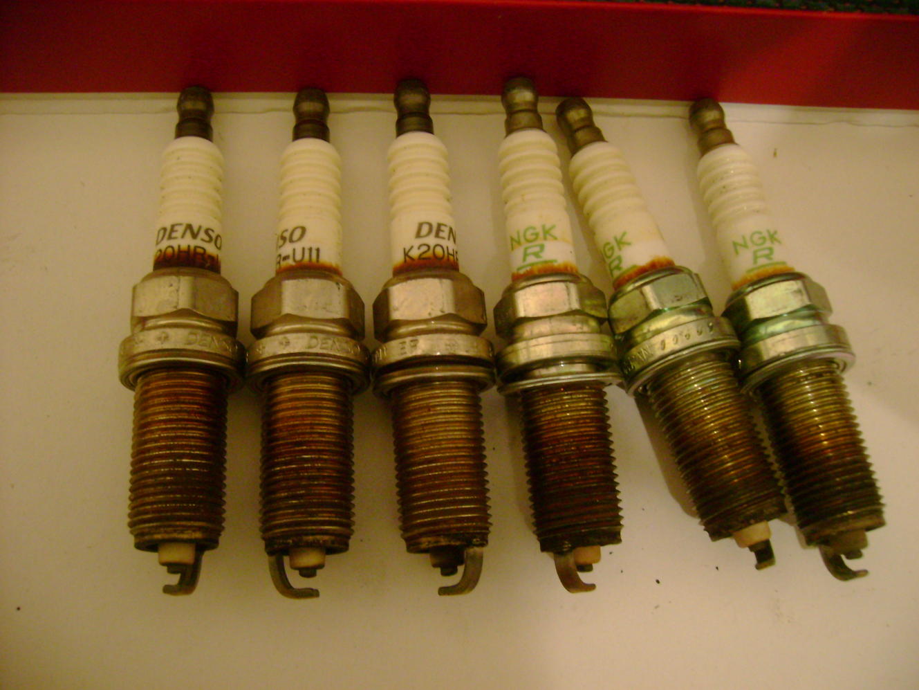

BTW, which plugs "looked" better? I remember that one brand comes out looking cleaner and the electrode is less worn than the other. Post pics of each brand if you can. Thank you.
Here is a pic of my plugs.

Do I want the NGK's or the Denso k20hr-u11's that are posted above for my 2005 v6 4runner?
