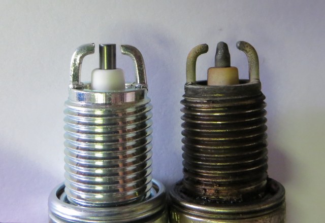

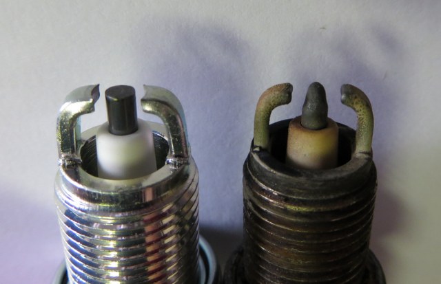

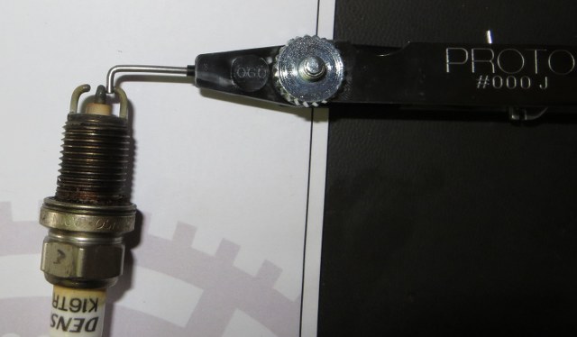

FWIW I recently pulled these from my '99 with 140k miles. It had Denso's on both sides, so they were probably changed once (plug wires were date coded 1999 though). I found one record for 60k dealer service, so I suspect these have been in there for 80K miles. Gaps were around .060" and it ran just fine.

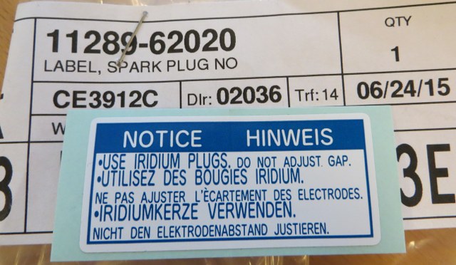

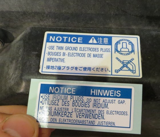

As an interesting side-note in regards to dual electrode vs. iridium, I had ordered the warning label on the timing cover as I thought I may destroy it while cleaning... This is the new label I received from Toyota:
Now that's quite interesting!
Not surprising they updated the requirement, since as its been stated before, technology has been improved quite a bit in the last ~15 years. Despite that, I ordered some Denso K16TR11 dual electrodes today, since I have no clue how long or what the current plugs are in there currently.
