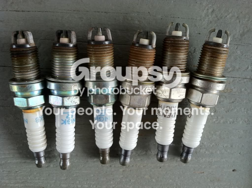

I admit, when my parents owned the 4Runner they never changed the plugs. I just changed them only a few months ago for the very first time. After installing the new Denso plugs I didn't feel any difference in performance so I think the old plugs were still useable, though visibly worn, even after 14 years and 71k miles of driving. But then again, I'm not exactly an expert with the technical details about spark plugs.
A pic of the old set:
IMG_3789.jpg~original
What are the chances that once those ground electrodes wear down like that, that the spark will jump to the piston top instead? That can't be good for the engine.
That is probably why Toyota wants them changed at 30,000 miles.
