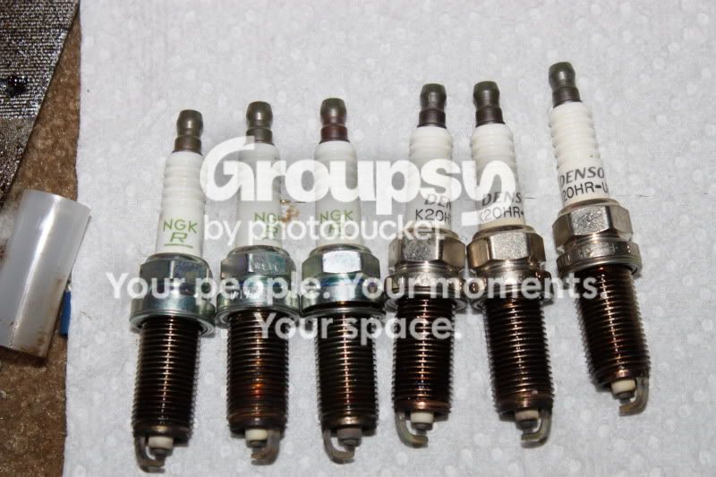

I had NGK on one side and DENSO on the other. I bought mine cerified pre-owned and thoguht that they got lazy and didn't change the hard side i was so PISSED! I never heard of using 2 different types of spark plugs because of emissions. any other info would be great :)

OK thanks, there were three NGKs and three Densos, here's a picture of them:
~original[/IMG]

I had heard that there was codes and what not to put in to open valves and stuff in the trans. I had also read that some people tried to drop the trans pan and only like a quart came out. I got my plugs from the dealer they told me there would be 2 differeant plugs and it was no big deal to just put 6 denso's in it. I have to say it ran much better after that I changed mine at 67k mine was easy to change to since I had a cold air intake not blocking my way lol
