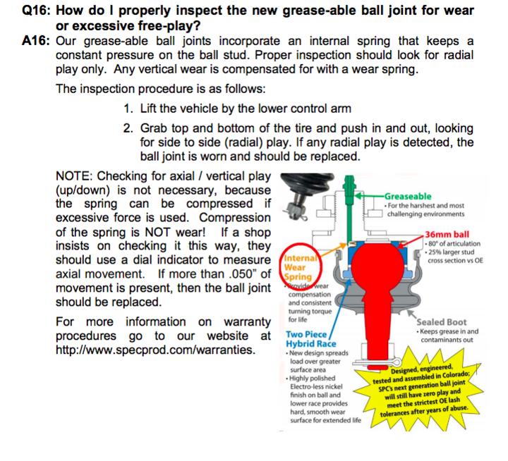

One more thing - who told you they were bad?
They are designed to have play. See this section from the FAQ.
