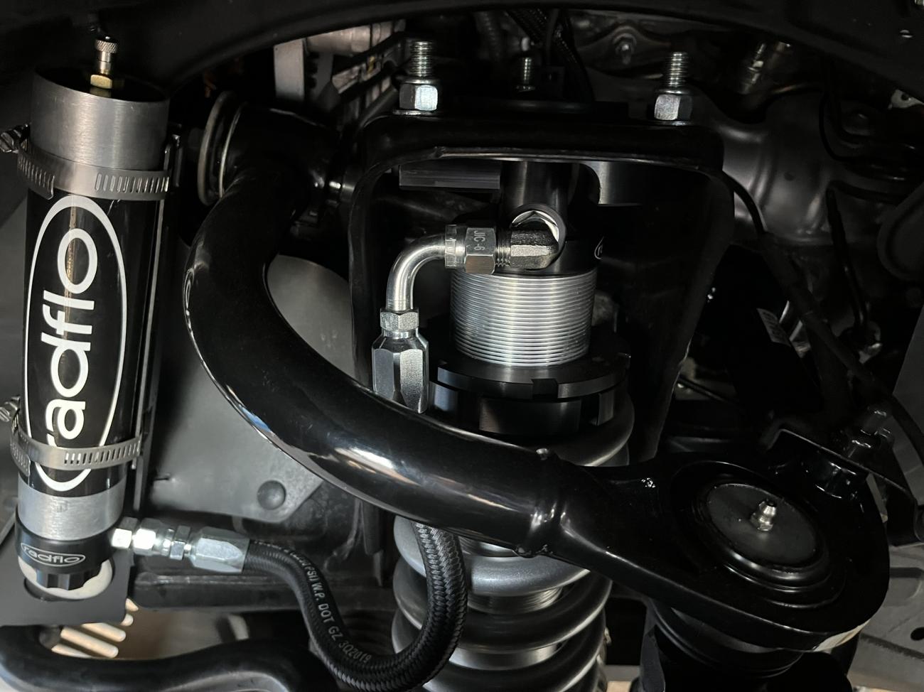

I was initially going to go with SPC’s, but my off road shop talked me into Nolathane UCA’s. Just got these installed last month with my new extended travel Radflo’s. No tire clearance problems with positive offset wheels. Time will tell. Attached is a link. Nolathane Upper Control Arms for your lifted 4x4
Features:
Fixed camber & caster rectification (for typical 2 inch lift)
Non-adjustable meaning no slipping.
Built tough utilising 1020 grade forged ball joint housing, forged end-rings and 1020 DOM tubing with 360º welds.
Heavy duty, greaseable, chromoly ball joints with increased articulation for improved travel and minimal binding.
GIIRO – the ultimate touring bushing with increased articulation while being lubrication and maintenance free.
