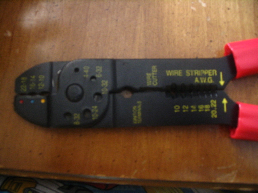

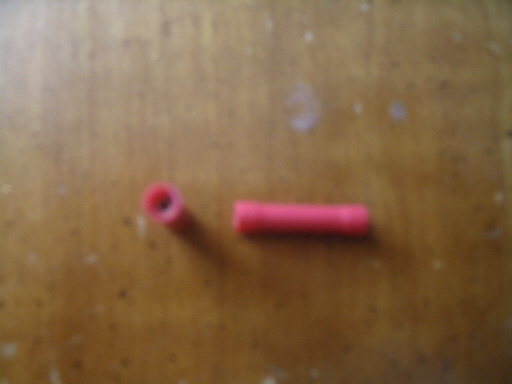

Hey i was kinda like you... but i think i can help ya out... seeing as im 16 also and we weren't ignorant as you said but new to the whole automotive scene right...we turned 16 we can drive we never thought about it b4...but i think i speak an understandable language ..... to change front door speakers...disconn. battery... remove the door panel...i have pics if you dont know how...i used simple butt connectors and electrical tape to connect my new spaekers... a simple cut and splice job and it works perectly too...
