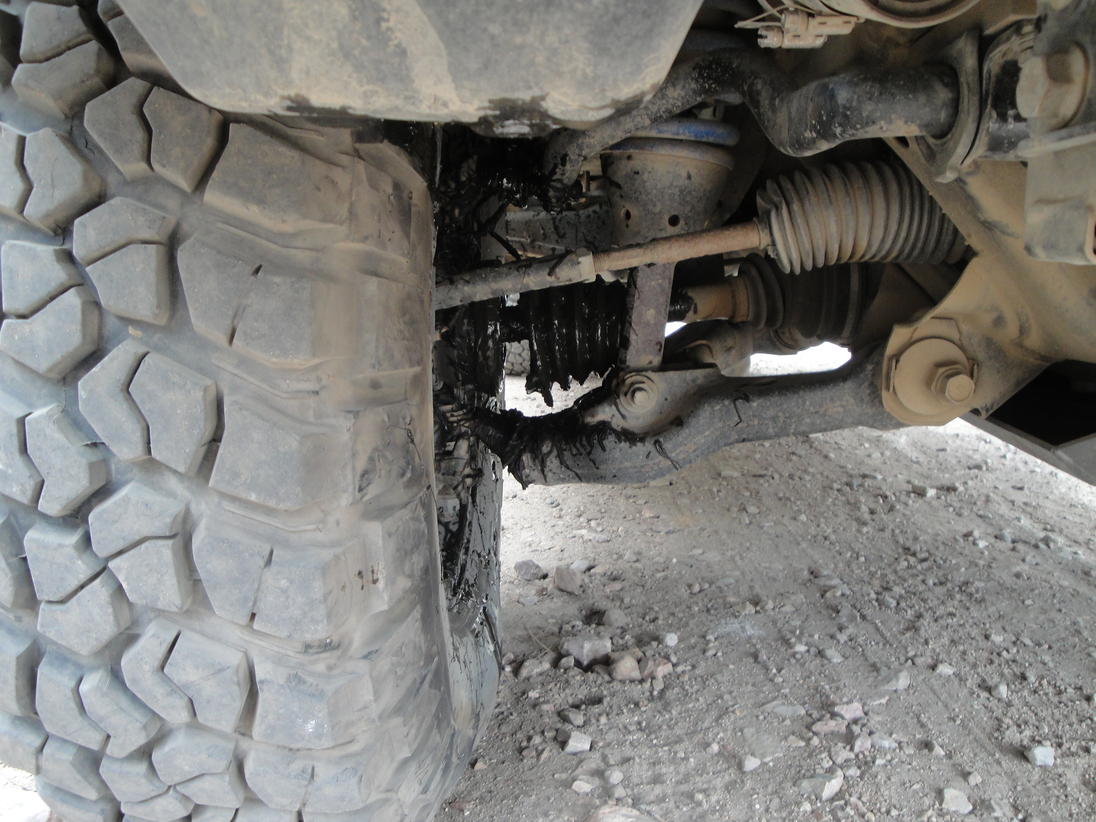

Buck stops here on this one. My fault, I hit a massive speed bump but it was more like a table top type platform than the standard speed bump. I was out of town and being a tourist - did not see it. To add to the situation I was hauling my motorcycle - I think the extra wt on the back of the rig added to the stress of the front when I hit the "bump of death". That wt could have forced the front to stretch too much?
All loaded up I bet I have 4 to 4.5 inches of lift up front? This was my 1st time hauling with the OME front springs.
I would think the truck could take a hit like this but obviously not. Not sure what hurt what but.. end result sucks. The rip in the CV boot is right under the sway bar and that was undone or broke druing the hit so that could have compressed and made contact?
Here is the upper A arm ball joint? Not sure of it's name?

Can your swaybar or its link actually hit the boot? There is a chance it tore it but it might have just overextended. It is not surprising to see the ball joint get trashed since you are using the factory UCA's and they can only handle such extreme angles.
Also, if you are running 4-4.5" of lift in the front, I would say that could have definitely helped cause this issue.

He actually is running a sway bar. At first I thought the same thing, but then when I reread the thread more carefully I noticed he said it broke. Also, you can see it passing in front of the shock. Its not attached to the spindle though, I assume that is the part that broke (it was on mine).

I have the OME spring up front so about 3 inches of lift but with the wt of the bike on the back and all loaded up with camp gear it made the back go down and the front go up some - so when I hit I had more than 3 in of lift up front. I do think that played a role in causing the damage. Here is a pix as an example of how much lift up front when it's loaded up - I am parked on a slight incline but that front end is jacked!
Just an update on what's been done and whats going on. 2 days after I hit the speed bump I had the front axles replaced ( I was on vacation and wanted to keep it going) -the passanger side has a very small rip - nothing like the mess of the drivers side. 200 in parts and 225 in labor -sucks, spent more on the rig than on gas, food and lodging. I saved both old stock axels - figured they may be of some use to someone or as a core for some shop and I could get some $ back.
I was running my sway bar when it happened but it broke off during the hit. You can see it missing in the 2nd pix. I think that's what tore the boot on the drivers side cause the SB was directly over the rip in the boot - it may not have tore the boot imediatley but as I continued over the bump to pull over the hanging SB may have tore the boot then?
The sway bar is and has always been super close to the bottom lip of the strut/spring and could have been detached if it made contact with the lower spring plate?
I don't know if the ball joints of the UCA are broke or if it's just the boot that is messed up. If I have to replace the stockers I may just do an after market UCA - any other options other than Camburg? The less $ Camburg uses the stock ball so not sure how to work that out if the stock ball is no good? The uniball UCA is much more $.
