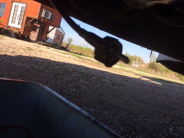

Hello. New user with a 1986 Pickup 22RE 2.4L speedo cable install. Sorry it's not a 4-runner. A brother from another mother perhaps. I'm gonna revive this thread, share my experience and hopefully get some more insight.

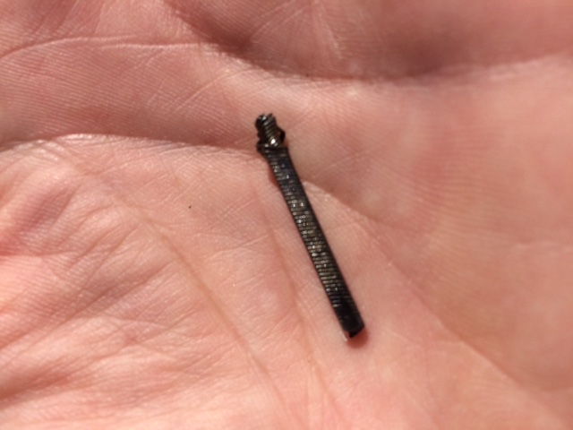

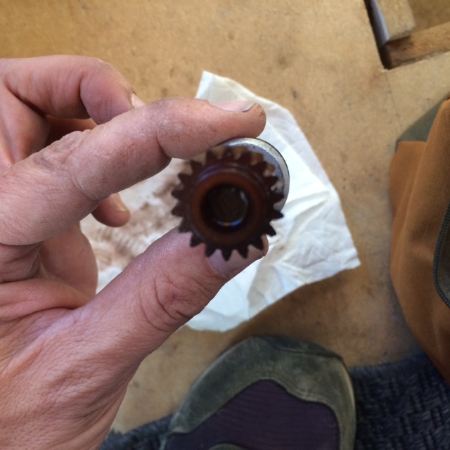

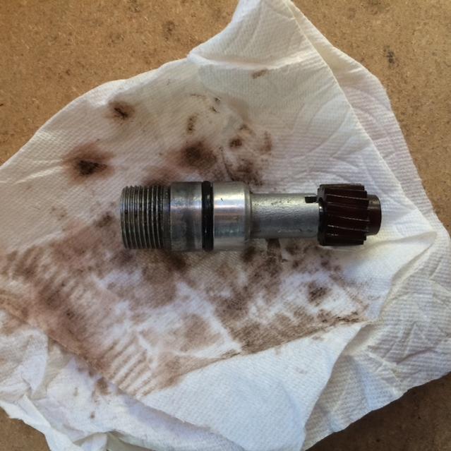

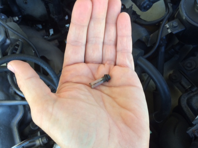

My experience is similar to some of yours. Found out the cable got mangled. When disconnecting from transfer case, the sensor piece with the gear looked fine (see photo) and removing the cable showed the broken part (see photo), so I'm hoping it's just the cable.
I figure I'll locate a custom speedo cable maker, hand them the old broken cable so they can fit to size the new one. Couple concerns/questions I have:
Hope that any nuts, attachments, etc. didn't fall off. Also, I'm finding that the previous owner did some wacky things to it. And I'm just a beginner with car fixes so I may be overthinking it. What are the essential pieces on a cable replacement (other than the cable) that could've fallen off or been messed with? I'll make sure to ask the cable maker to accommodate the essentials.
I'm also seeking a longer cable (about 18" longer) than the original that broke. It's because I don't want to mess with the speed governor and vacuum actuator, so l'll need to bypass it. Other than I think it'll lose the cruise control function, do you foresee any other issues with bypassing?
