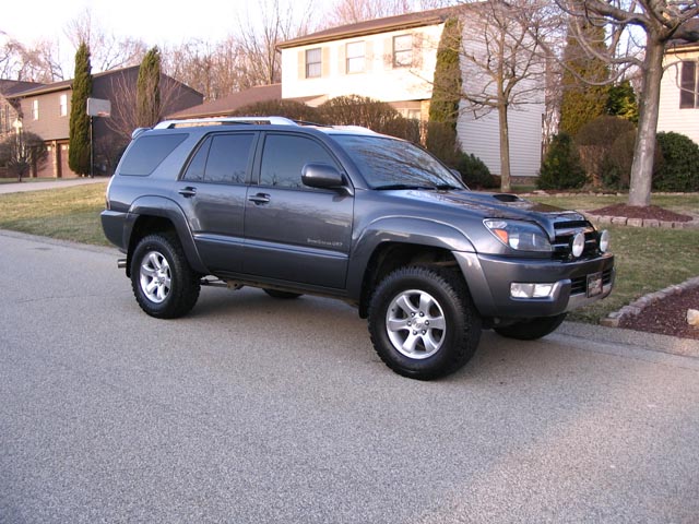

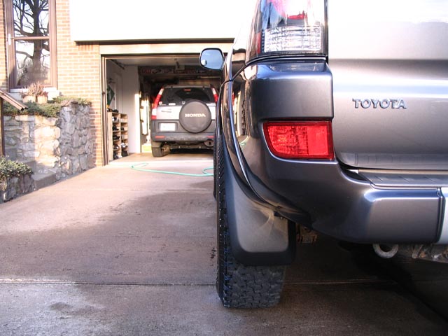

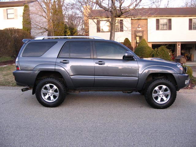

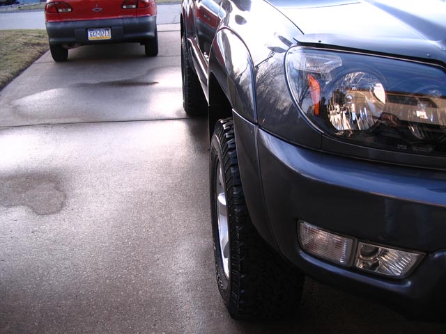

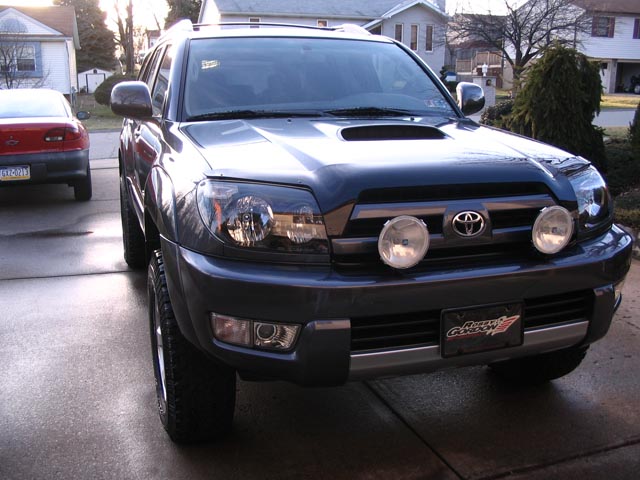

Some clean pics of the truck with the spidertrax installed and 35% tint from snaptint.com applied...wow, that snaptint was easy!!!

lookin good! mods look great, the tint really balances out the look of the glass.

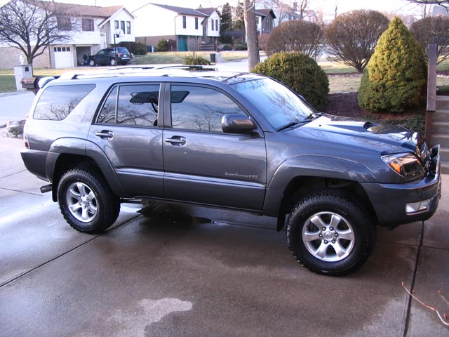

Looks great bro. Ive got a T4R sport with 3/2 and 285's and was thinking about getting the spider tracs also. What size did you get. Do you get any vibration. Did you install them. I really like the stance of the T4R with the wheel spacers.

thanks man...I got the Spidertrax 1.25 from Burtman Industries...these things are awesome...no vibration what so ever...and yes, I intalled them myself....fairly simple, but you should have a torque wrench since the spacers and your wheels need to be torqued to a specific ft. lbs....I think the spacers would look great on your rig!

Today I just installed a new set of BFG A/T KO 285/70/17's and they rub my UCA's bad when at full wheel lock. I have the Total Chaos UCA's. I thought changing out the stock UCA and going with the Total Chaos would eliminate any rubbing on them. Boy was I wrong. I didn't want to use spacers, but now it looks like I'm going to have to or switch out the tires to a 265/70. I could of saved some money on the TC UCA's and bought sliders:mad:

snaptint.com...precut, smoke, 35% all the way around...done by me...I can get you a closer shot this weekend...
hey beanz, you should email Jason Burtman and he will hook you up with the spacers...they are easy to install and I have no vibration at all...I love these things....I did have to adjust the inner fenderwell a bit...you can see pics in my old spidertrax post...

The Jaos Aura grille I got from Burtman's. It took about 2 to 3 months to get it from Japan. They don't make them untill you order it. When it arrived it was just primered white. It was $429 + $170 to paint and bake it to match the color of the truck. People are always asking me what kind of truck I have when they only see it from the front.
